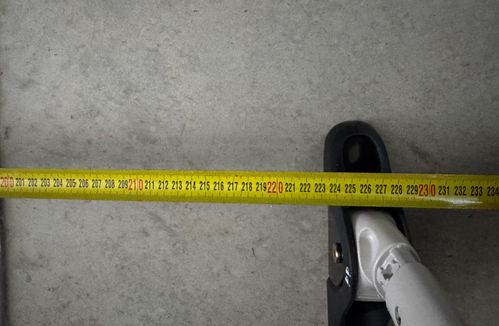

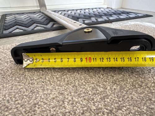

Hi bought a fold down fence from Bunnings but it has only masonry screws which is probably because it’s where is recommended to install. However the best location at our place is on the wooden fence. Request guidance on how I can best do it so it doesn’t warp under weight. Fence posits are about 2m apart and the width of the cloths line mount is 2.26m wide. I believe it is recommended to install on the posts only or maybe make a bridge between two posts? With a slight over hang past the posts hope a bridge will work fine? Would it be recommended to put additional vertical posts in the ground with a concreted, cement mix to make like a frame!  Appreciate all info and help please.
