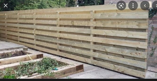

I am erecting a 7 meter windbreak. It is not a fence and in a rural area that faces due south from which we get hefty wind gusts.
I understand windbreaks create less turbulence when some wind is able to pass through rather than all over the top. Hence I am thinking about this design above, using 150mm plinth boards. However, my wife would like it painted, so I'm considering treated pine decking. (Bunnings have a 90 mm x 22 mm board) which is easier to stain or paint. Consequently, it uses more boards.

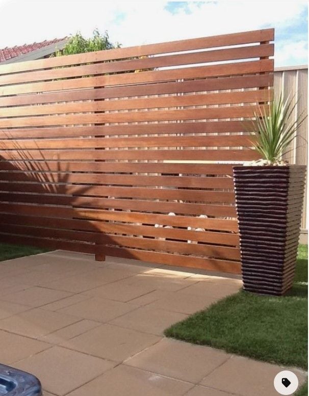

I'm wondering if the design below with space would be just as effective as the above design where wind has to feed through the gaps. I can't find any studies or research which compares these designs.
My other concern re the plinth boards is that they sag and warp over time.
Grateful for any thoughts.
