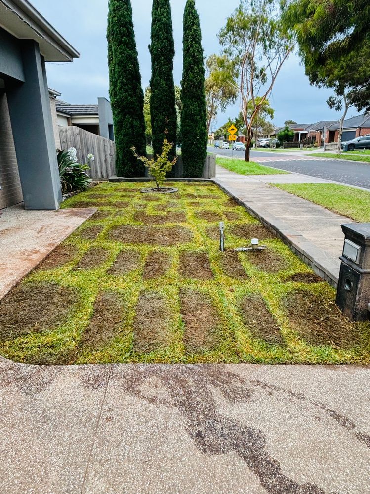

I have installed the Bunnings sir Walter’s buffalo grass turf couple of days ago. Some of the grass turfs were green however some were brown at the time of purchase.
the roots of the brown grass are white and not able to easily tear however I am concerned whether I have purchased dead turf patches. Please advise if the grass would be green in couple of weeks and does Bunnings sell brown patched buffalo turfs (which might be expected and normal)?.

Hi @vish9
Those rolls look dried out in the middle but if you notice where the water is getting between the rolls on the down hill side It greening up nicly already and will spread to the middle just keep up the water up to your lawn maybe before and after work watering sessions until the roots establish themselves into the surrounding ground. Right now the roots only have the soil they came with in the roll itself and that is tough at this time of year but the rains will help alot. Some times top dressing the rolls with organic rich soil will help speed up root developement through capturing water more evenly and stops the rolls dryng out as quick.
I can see your lawn lush by the end of summer.

The attached pic is taken at 4th Jan when I purchased and installed the grass turf.

One point to note for all who purchase turf is that it should be used asap after you pick it up. If you let it sit for too long, in particular in hot weather after you pick it up it can cause burning like this.
Not saying that this is what has happened here but just a warning for others.
