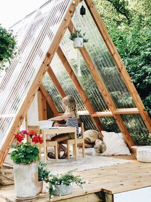

Almost done gathering materials.
Happy to share my progress ☺️
Here's my inspiration pic! Wish me luck!
