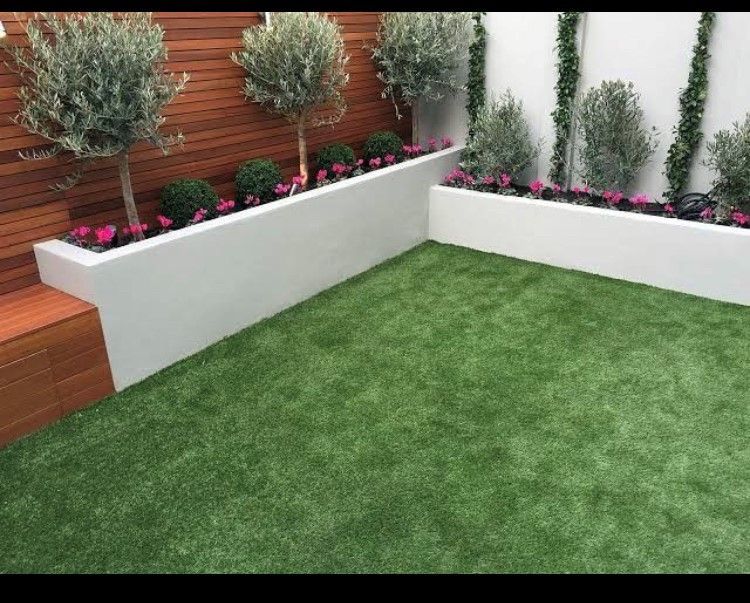

Looking for some advice on the choice of concrete blocks for the walls of my raised garden, similar to the attached image. I would like to use concrete adhesive rather than mortar as it might be faster. Only going three blocks up.
Now, I've looked at both the adbri versa blocks but they are too wide for my liking. A little pricey too.
These Brighton blocks come in 90mm thickness and suit the thin look I prefer but the reviews on it are pretty average and one person says there are too rough to use adhesive on. Does anyone with experience using these? Are they any good, especially if using adhesive instead of mortar?

I don't see anything wrong with using Brighton Blocks, they are on the slim side but should work as a low-level wall for your raised garden. The other choices of course are the 200 x 50mm Sleeper H4 Treated Pine Sienna MicroPro 1.8m or using Brighton Masonry 230 x 114 x 60mm Cream Concrete Paver.
However, the Brighton blocks gaps will need to be filled with concrete to provide rigidity and strength. I recommend having a quick look at this guide - How to build a raised garden bed by @Adam_W. This guide will show you an excellent method of building a raised garden bed using timber sleepers.
The third option of course is using Brighton Masonry Pavers. It is possible to glue them together, but I'm afraid that it can't go very high as there is a strong possibility of the paver toppling over or sliding out due to the weight of the soil.
One other option I failed to mention is using bricks, however, it will be necessary to build a foundation to prevent the bricks from sinking into the soil. I suggest having a quick look at this discussion - Advice needed to lay brick raised flower bed by @Brunnie_Rich.

I have a few Besa block styled walls. These are retaining walls and not garden bed walls but my way of thinking if I am turning a garden over with a shovel then the bricks and base need to stand up to that kind of leverage. @EricL suggested a foundation base for a garden bed made out of the blocks. I would agree with him for sure. The walls I have at home have no base other then compaced dirt. The blocks were mortared and over time the walls have cracked. but Once there is a large crack / diplacement in the wall then then whole lot will move.
Foundations are permanant, this is probarly why I havnt gone down the path of masonary. If you chaneg your mind on the style of wall and looka t the various gabion style walls theer are then yes
I can help you there and they dont need foundations. I have put in a few cages as retaining walls and two taht I intended to backfill with garden soil to actually grow things. (These walls were around the 25cm thicness mark)

Do you have a photo of the area you want to puild in? What is the base soil (Clay, landfill, Coalwash) Is it backing onto a solid wall or is it freestanding? I do like to try an think outside the square for a solution and yeah I know the ones I have offered arnt anywhere near a brick wall you described. Will keep thinking about it tho!
I have just been watching some how to videos on youtube with the Versawall blocks. I may have to change my opinion of them!
They look good and the ones I saw have no mortar or glue (Bar the corner block) between them. They were also put down on compacted road base and some sand/concrete mix. Maybe that is a standard?
So my opinion has changed, those type of blocks do look good and look pretty easy to put in.

You’re right @Dave-1 @I’ve watched lord of versa block videos over the last few weeks. They do look amazing once you get the base and first course right. Even seen some reviews of them 10 years after they’ve been installed and they cope pretty well. If I can’t find any easy to install block solution that is slim, I might end up going with them - it’s just more expensive than the slimmer bessa block solution
@Dave-1 - yes, never backup to a fence. That would be a pain in the future for neighbour and yourself. If I do go for the versablock solution, I would probably go for H4 sleeper wall on the back (fence) side - can be hidden away by plans
