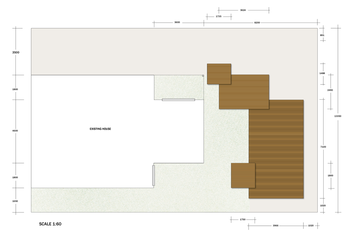

The attached plan will show you the basic idea for the Merbau decks. These aren’t the final dimensions and are just based on the drawing. The block slopes slightly down to the right and we were thinking of a series of smaller decks (platforms really) that step down to the main deck on the right.
We want to have these close to the ground. So I’m thinking to raise them so there’s around 200mm clearance underneath. I’m also thinking about a single layer frame using 140x45mm H3 – exactly like the fame shown on the low-level deck built by jase2, here:

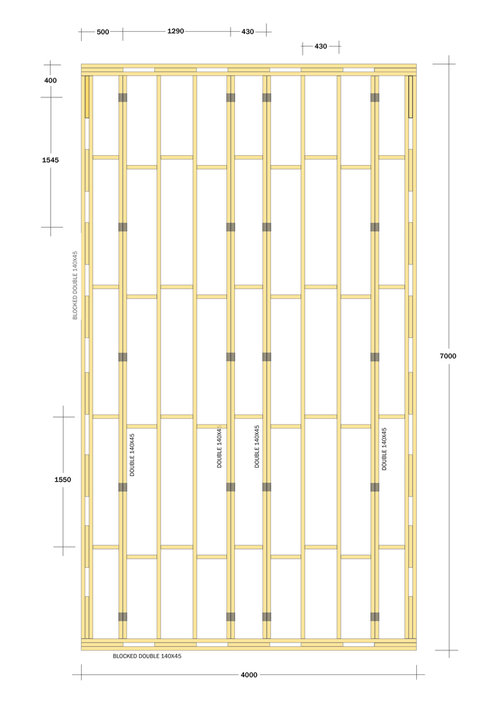

Re: Timber spans for single layer frame
Hi @Jimmy2,
Was this similar to what you were thinking? If so, I believe it would work. I've used 140 x 45mm supported twice over the 3966mm width as the bearers and 90 x 45mm spaced at 450mm as the joists. Bearers are spaced every 1200mm across the 7100mm length.
Hey Mitchell,
Wow, I wasn’t expecting you to go and design it for me! Thank you.
What you’ve designed is very similar to what I was thinking. But I do have a couple of questions.
First, does your design not feature any double timbers fastened together?
Secondly, because of the single frame design (bearers and joists together), your design means that all of the joists are effectively great big noggins. Therefore for strength and rigidity the decking boards aren’t fastened to any joists running the full length.
So, I’ve been busy drawing up what I have in mind that uses the lateral strength of the long joists to fasten the deck to. I think it might be ‘over spec’.
Continuous spans between the stumps are 1545mm with a 500mm cantilever over each end and a 400mm cantilever over each side.
The joists are at 430mm centres.
Additional double joists run down the centre and are supported by extra stumps. There are also additional doubles down each side. It might be overkill?
Noggins are in four rows that are 1550 apart.
The blocked double joists allow for the corner posts to be concealed and a fascia installed to hide underneath.
So see what you think and please tweak, delete, alter or change anything you think is unnecessary.
