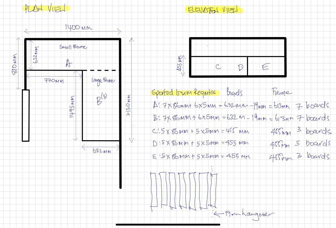

G'day, I'm building an outdoor bench seat that will be under cover of a third floor outdoor deck/balcony BUT very close to the ocean (Phillip Island) - therefore exposed to the elements. It will get wet during rain periods. I'm going to be using Spotted Gum as the cladding/outside of the bench seat and treated pine for the frame (as it needs to withstand the elements). Question I have is do I use 90x35 or 90x45 treated pine for the frame? There is an obvious price difference between the two sizes and I need to reduce my overall cost BUT also need to ensure that the bench seat is going to be sturdy and strong. Any help appreciated!

Would you happen to have a sketch of the seat you are building? If you can please share a picture of that sketch, it will give our members a better idea of its structure. We can then make recommendations on timber size. If it is a three-seater or larger, I would suggest using the 90mm x 45mm, but if it is just a two-seater it might be possible to use the 90mm x 35mm. You can even technically use the 70mmx45mm if the spotted gum can provide extra support to the frame.

G'day Eric, thx for getting back in touch with me. Please find attached Plan and Elevation diagrams for the design. Basically the bench seat is in an L-shaped config at the end of our decking balcony. It's going to consist of two frames "Small Frame" and "Large Frame". The frames will be made up of treated pine and the cladding will be spotted gum decking board (19mm x 86mm x 1600mm).

Thank you for providing those detailed plans of your bench seat. I was initially concerned that you would have a very long seat, but now that you've shown me the plans, I suggest using the 90 x 35mm Outdoor Framing H3 Treated Pine - 2.4m for framing. It's not too bulky like the 90mm x 45mm, but it is strong enough to hold the weight of people sitting on it. My best advice is to drill pilot holes on both the frame and your spotted gum to prevent splitting the timber.

I prefer the 90 * 45mm pine :smile: Mostly because I figure you will have characters flopping down onto a bench seat and that little extra cannot hurt :smile: I also like @EricL's suggestion of pilot holes.

Thanks heaps Dave! Yes, I was definitely going to put pilot holes AND will definitely oil it! I will test the 90x35 and 90x45 for bowing when I pick up the timber tomorrow night. I figured the longest span without support is going to be approx. 700mm hence why I think the 35mm should be OK.

Love your plans and I can't say I have much to add than what @EricL and @Dave-1 have already contributed. Except for the choice of timber! I'm on the other side of the bay to you and I have several spotted gum deck mostly exposed to the sun and weather. If I had my time again, it's the last choice other than treated pine. It looks awesome when first laid, but I can guarantee it will bow, split, and deteriorate rapidly even when coating with several layers of the best oil. I have already replaced boards within 5yrs and the last lot are already showing signs of deformity.
If you're looking for something other than Merbau, which is always a safe choice then consider Blackbutt.
