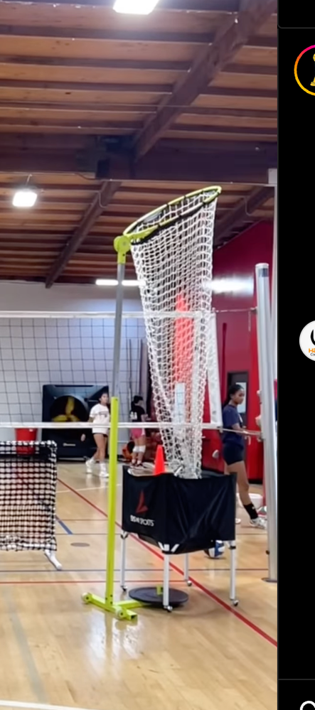

Hello ! I'm a coach and current player and have found that this equipment is overly priced to buy through normal sports retailers, so I am looking to cut some corners and build one myself. But am not a handyman or been one for DIY projects previously. Could anyone familiar with materials and DIY give some advice on what things I would need to purchase to make this come to life please ?
Volleyball Target Hoop There is another link to a video where you may be able to take a closer look at. Thank you for any advice !!

I like @EricL 's suggestions but not sure how to change the angle of the hoop itself. Looking at the piviot point in your photos it reminds me of a part that is familure
I might take a wander through Bunnings metal product aisle to see if it can prompt my memory.
That yellow stand looks like something the metal extrudsion aisle will have in parts, that join between the hoop and the stand is my main baulking point.

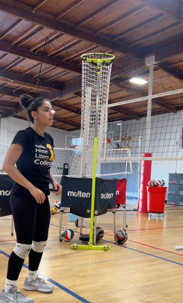

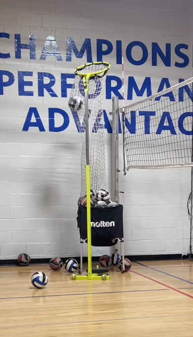

I think those suggestions are definitely in the right vein of what I need. My worry though with using basketball hoops in similar scenarios that I have done before, is they are a bit small. Volleyball has a lot of accuracy in it, but basketball and netball hoops are a bit too small for efficient training with them. The plus of the examples I have shown is that they are larger hoops that allow for an area to be the target rather than the hoop itself being the main objective. Not sure if that makes sense, but that's why it does worry me a bit to use a standard hoop from those sports. In shorter terms, less room for error with standard basketball/netball hoops.
The ideal is the adjustable netball pole, with a larger hoop and maybe some netting that comes down to the floor (like in the photo) to ensure the balls aren't bouncing everywhere after they go into the target. I might look at the adjustable netball pole in person and see if I can figure out a way to make my own sort of 'hoop' to a size that works a bit better for the intention of the equipment. And then just find some netting and attach it to the makeshift hoop haha.
