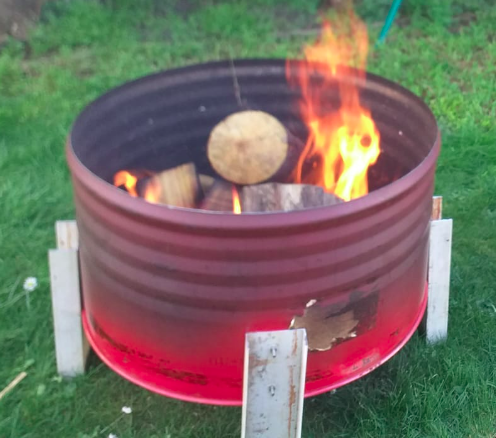

I'm making a fire pot with an old oil drum. I want to make a lid to prevent sparks coming out from the pot.
I have cut the drum crosswise and put it some metal legs. That's working good. See picture below.
I would like to add some expanded metal or similar inside to give more air to fire. But I think that step is coming after the lid.
It still needs to be painted, but that will be the final step. I will ask for advice in this regard in the future.
I want to use the other end to make a lid. I'm thinking of making some gaps in it and then putting a mesh in it. What kind of mesh could I use? It has to be something flexible so that it can follow the circular shape of the lid.
Would something like this do the trick?
Thanks in advance for any advice.

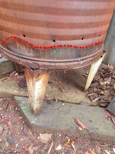

Morning @lbianchi and others.
Congratulations on your fire bucket/pit/drum construction. 👍 I hope you get warmth and fun from it.
May I offer a suggestion about the legs?

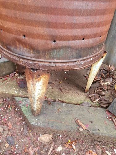

My 'experience' with 44-gallon drums as fire buckets (very thin sides) is they perish quickly, just around where you positioned your lower bolts. The heat generated is simply incredible.
This has only been lit around three times...and already it's buckled and distorted at the bottom. Possibly better if you can position the legs under the drum.
The drums these days are very thin-skinned. As each drum perished - I cut it off at the base where you see the rounded edge section and kept adding it to the last base with the legs. Just a few spot welds holds the new drum in place. There are three bases seen above with a piece of steel plate welded around them and I guess I will keep doing this till the interest wanes. And yes, it's progressively getting taller. 😁
