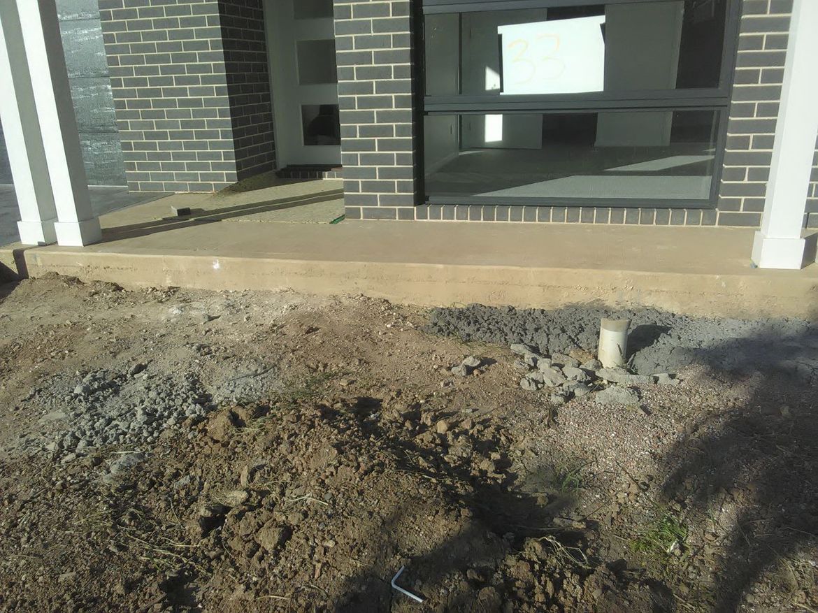

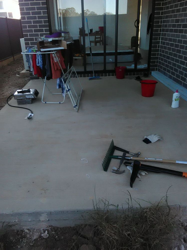

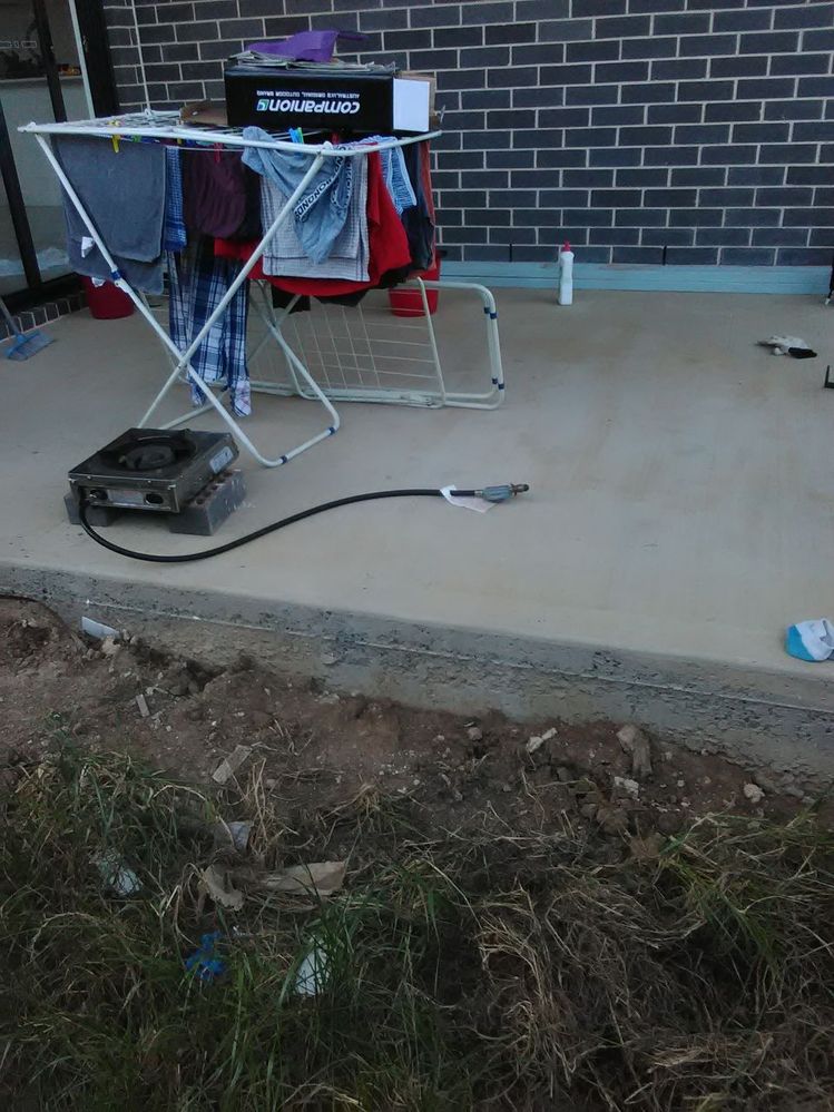

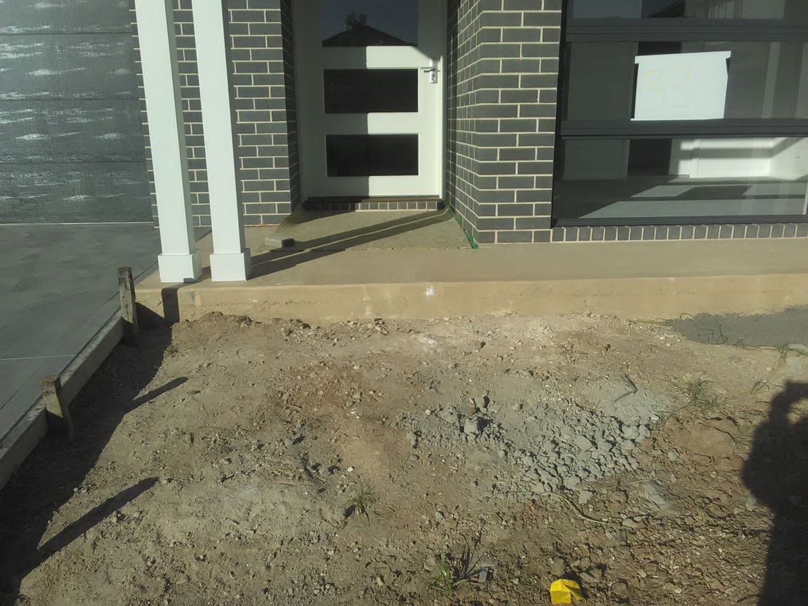

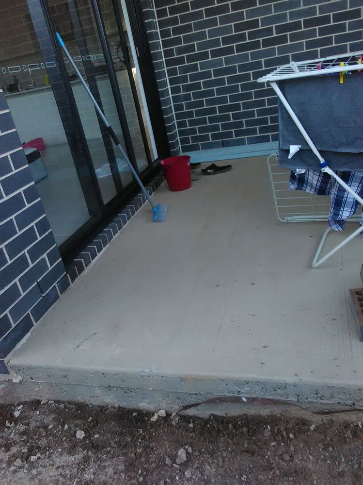

Dear @EricL ,
I have uploaded pictures of my alfresco and patio that I wish to deck. You can see the weep holes above the first course of bricks which I don't want to muck around with for warranty purposes as its a new build. Please also excuse the mess. The setdown is 70mm and that is the height I have to work with. So in theory, I have 35mm height timber framing, with about 15mm of ground clearance and 19mm Merbau decking. That is if I use the flat side up of the 90X35mm or 70X35mm. I can't think of any other framing system. I will use the window plastic packers to achieve the clearance. What are your thoughts?

Hello @khusnil_deo
Thank you so much for posting those photos. Let us for the moment consider that we can build over the weep holes. How much space would you be able to use then? At the moment 70mm is not enough space to build a solid timber frame. If we take away the thickness of the decking panel which is 19mm you would be left with 51mm neither the 70mm nor 90mm timber framing will work. A possible option would be to use a metal frame, but you would have to engage the services of an engineer as they would be familiar with the use of the material.
If you place a timber buffer in front of your timber frame so that the weep holes are not covered it will still allow them to function as intended. The weep hole's purpose is to allow air to circulate in the brick wall. This is to prevent moisture from getting trapped inside your wall. As long as they are open and uncovered air will still be able to enter in and out of them.

Dear @EricL ,
thank you so much for reply to my post. Unfortunately I still have that 70mm height to work with to make the deck flush with the brick work just where the entrance to the alfresco sliding door is. In the front patio I can make it flush with the door jamb but the finish will not look nice without the picture frame. I have seen people use the flat most part of either the 90X45 or 90X35 and they use packers underneath it. they just have to make sure that the space between each joist is closer than the recommended 45cm. and they waterproof the joist by applying bitumen paint.
