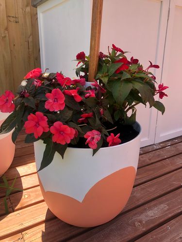

You could use any planter/pot for this project. I chose a plain white one which I could paint but you could use any.

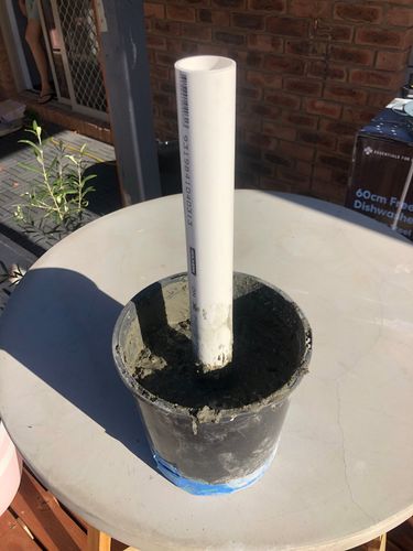

1. Measure the diameter of your umbrella pole and buy a bit of pipe that is slightly larger.
2. Cut the pipe to size and set it in concrete in a smaller plastic pot (make sure to cover the holes)

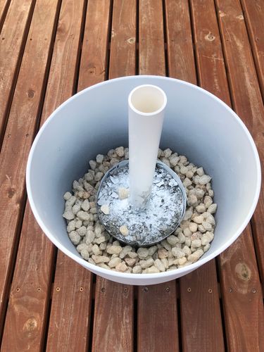

3. Fill around the smaller pot with pebbles to help with drainage.

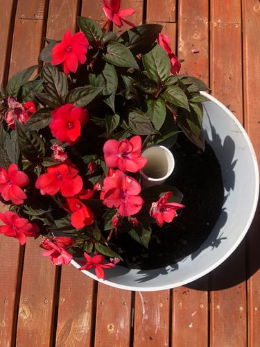

4. Add potting mix and plant some flowers you like.

That looks wonderful, @shannonrennison! Much more aesthetically pleasing than what's on offer with traditional umbrella stands.
Did you need to use a particular type of paint on the pot? I love the design and colour you've chosen. I've recently used some Crommelin 1L Liquidstone Terracotta and found it excellent on pots and ornaments.

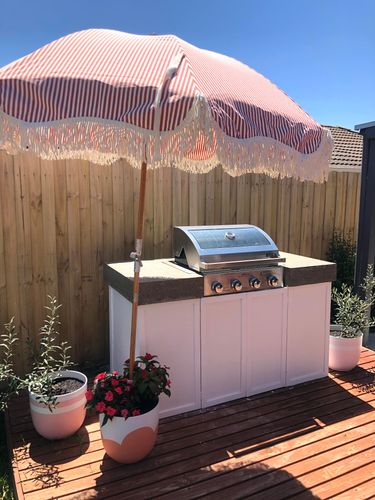

You've created an amazing space for BBQs, entertaining and relaxation. Many thanks for sharing.

Looks great!
I noticed the umbrella can be angled. If you do so is there still enough weight to prevent it falling over?

Thanks Mitchell,
I primed the pot with rust oleum spray paint and then just painted with a regular Taubmans sample pot. I sealed it with with a rust oleum clear sealant after that
Re: Umbrella stand planter
Definitely holds the weight when it’s folded. I am going to add a large wing nut through the top of the pipe to keep it more secure in high winds but it stays quite well without it
