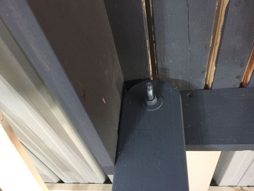

Lovely work once again, @GeoffB. I really like that gapped look you've achieved. Would you mind explaining how the legs fold up? I trust many of our members would be interested to see that, as storage of tables like these can often be quite difficult with fixed legs.

To make the legs of this table able to fold up I have made the top end of the leg half round and fixed it to the side rail of the table with a bolt . There are two washers between the leg and the side rail to allow the leg to turn between the open and closed position.
