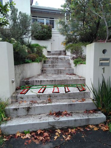

I have concrete path/stairs that need to be resurfaced and looking for alternate to paint or tiles (though may end up tiles if cannot find anything else suitable).
They were painted when we bought the house 15 years ago, after peeling/wearing, several years ago I grinded off the surface and repainted with paving paint. Only took a couple years before wearing off again, so now want to resurface with something that will be long lasting as don't want to do it again.
Had thought about stone tiles but will be expensive, a landscaper quoted $30k for stone tiles all the way to front door, yikes, way too expensive. I would be prepared to do it myself (taking my time), using 10mm stone tiles which would probably cost about $5k plus cement/adhesive/sealer & hire of tile cutter (the one that use water so no dust) as there would be lots of cuts. This will still end up quite expensive and take quite a bit of time.
Hoping for any ideas for other products that I could use that will be relatively hard wearing, long lasting and cheaper than tiles. Thought of laying pebbles, another post mentioned MaxPRO pebble resurfacer but Bunning don't seem to carry this product anymore and not sure how it would go on risers.
Also of note, quality of concrete not the best, flights of stairs at top okay (this seems to be better quality concrete) but rest of path seems to have lots of sandstone rocks/rubble, hence quite a few hairline cracks.
I've attached some photos, one showing a bottom step I removed because it was cracked, the stones on step above is what it was made of which I did couple months ago, first 2 photos from couple years ago, paint got a lot worse. After repairing step with new concrete, have grinded back the whole path.
Thanks.

I have had the same type of issues as you over the years. Looking back at I figured it was just old paint so I left it. Once I started replacing paths and changing things I found that root cause was the shoddy "fill" that they had used on the steps, it allowed water to pool and seep so the paint would fleck off... As soon as I saw you third picture it brought it back to me ![]()

To throw in some other ideas instead of tiles....
You know that dotted foot gripping squares you see at lights/railway stations to show edges, some form of product like this?
The small discs that are stuck to the concrete to provide gripping. Surface could be painted and these added afterwards, there should be no wear on the paint as the dots will take it.
For the steps, I was thinking along the lines of a steel grill, think steel strips about 1 cm apart with square edge to attache to the concrete so they dont shift. (cowcatcher type deal) A local welding company may be able to help out or a mens shed in your area?)
The last idea and the idea I like the most is a low line decking idea, a cheats way of doing it if you like.
No bearers but using rubber strips under merbau slats, A lot of people have asked about low decks and this is the closest I can come up with, Do not guarantee it would work long term but its a different solution. Please note there will be little air being able to circulate so something to consider.
So the black under the red is rubber stripping much like you would use on joists something to keep the timber off the concrete direct, you could also use compressed rubber squares instead.
The red is merbau slats
The green is merbau slats
The reason I have laid them this way is to allow water to drain down the steps and not build up behind the timber
Id hose the area (you probably already know without knowing lol) and watch for the fall of water, make sure the base slats dont block your run off.
I would bolt the red slats down through the black rubber wither end with concrete screws/anchors,
If you dont like the idea of bolting these are big enough to sit on the steps, you could get a "feel" if you like them?
So 19mm + 19mm + 6mm for the compressed rubber, makes it around 44mm higher, the bottom most concrete may beed a "fake" one just to keep the heights all the same.

Thanks for some different options, timber certainly wasn't something I would have thought of, definitely and option to consider, and appreciate your explanation on how to lay it, and the rubber base makes sense.
Job started out with intention of cleaning out & filling just the cracks on the 3 bottom steps with Betta Concrete Crack Filler (great concrete filler, liquid really sink down into crack), started chipping more of the crack away and ended up removing 1st and 3rd steps completely 😩.
Ended up leaving out the 1st step (as it's on the verge but will raise the ground in front), the 3rd one (now 2nd) filled with concrete and some reo bars, ended up pretty solid.
All paint now off, used a flat diamond disk, and most cracks filled, maybe just some hairline ones left. A bit hesitant to go tapping the rest with hammer though, I guess better to do it now rather than wait for potential problems later on.
