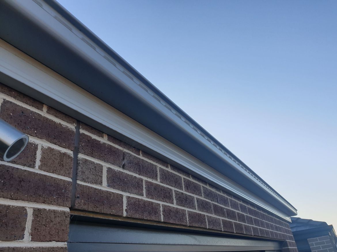

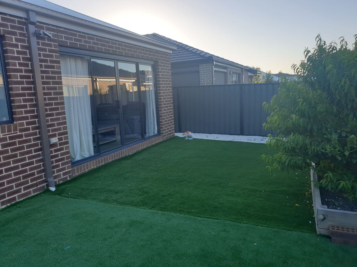

Im planning to build a pergola with a flat roof. I was planning to dig two posts and attach a wailing plate to the house, but not sure since the dimensions are 5mx4m. 5m along the house, 4m roughly to the garden bed. Which timber should I use? What's the best way to attach the wailing plate? Should I bolt it directly under the fascia or attach it through screws to the rafters through the fascia itself?

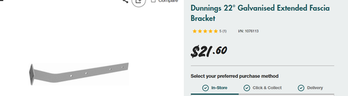

Hi @Adam2 . I would highly advise to attach Fascia brackets like the below. It then attaches to the rafter (also include a rafter stiffner) to get the correct support. You then attach the wailing plate to these fascia brackets. This part is the most time-consuming for the whole project, but the most important. Check out Softwoods, they offer a brilliant solution to get a great design at a good price - you still construct yourself but it takes a lot of guess work out. You can special order through Bunnings.

I recommend planning your pergola either on paper or computer. This will define how you want the pergola to look like. I suggest reading the previous projects that were contributed by other members. Once you've decided on a look, then you can start deciding what kind of timber to use. It sounds like a fantastic project. Any updates you can provide would be much appreciated.
