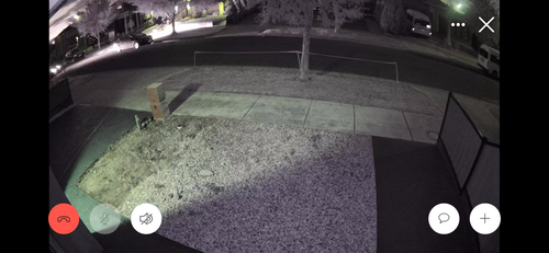

Hi there, I need complete measurement to set up the Merbau fence panels with metal post for my front yard.
Size of the front is 7 meters in length.
Thank you.
