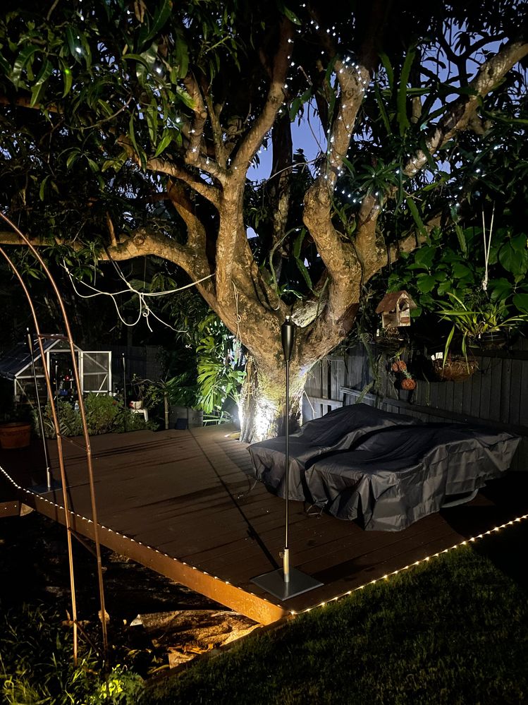

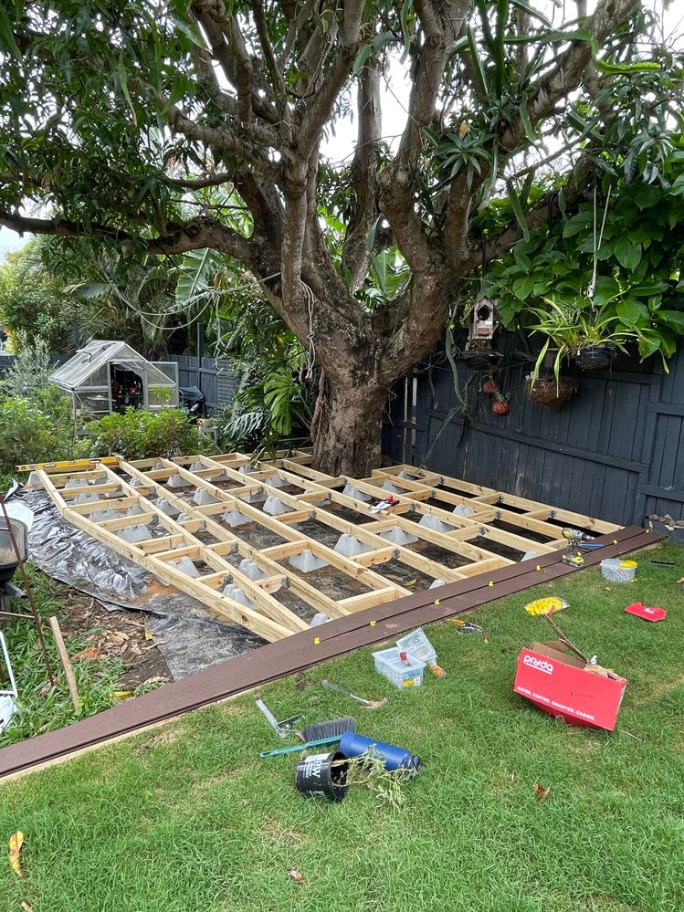

UPDATE: We have finished the Mango Tree Deck...and couldn't be happier with the result.
Took three days all up to complete.  We used EkoDecking.
We now need to get deco delivered so we can finish the footpaths that will lead from deck through the vege patch out the back.

Thank you so much for sharing your construction photos. Your deck framing looks very well supported, I see from your build that you've used DEKO 250 x 150 x 150mm Instant Concrete Foundation Block. Was it easy to use and level or did you level the area first before laying the blocks? Your deck looks wonderful and I'm sure it's a great relaxation spot as it's right under the tree. Are you laying down a footpath? I'm sure our members would be keen to see this next part of your project. Any updates you can provide would be much appreciated.

We actually did level the area as best we could before laying down the builders plastic but then had to do some minor adjustments using deco. under the concrete blocks to get the supporting frame more level.
I originally wanted to use tuffblocks being they were lighter weight and also sit a little closer to the ground, but the Bunnings trade people we were dealing with recommended the concrete blocks.  They were just awkward to handle and move but all in all okay for this first time deck builder to do on her own.  We are planning on a footpath using compacted deco and stones - stay tuned for updates once done :wink:
