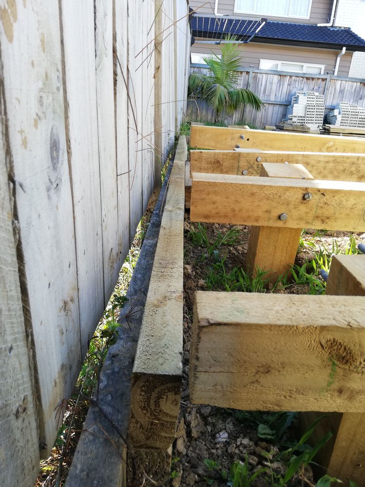

Hi Mitchell
I have started working on my project. I got some one to dig holes for me. Since, I am working alone I am doing it a bit different to what normally people would do. I am just aligning all the posts before I pour concrete. I didn't want to do a lot of timber cutting, hence bought precut posts. 600 mm in length - circa 400mm in ground and 200 above. The problem i now have is, i don't have enough space to use the batten screws to fix the joists to the frame. can i use angle brackets instead? (i know the work i have done so far looks shabby at its best but this is only my 2nd project - the first one was a shade sail). I will wait for your reply.
Hello @jinugu
Thank you so much for posting an update on your low-level deck project. If you're going to use angle brackets for the "joist" or that outside piece of framing timber, I suggest levelling and aligning everything in place first, then pour the concrete into the footings. You can then attach that piece of timber after everything is in place.

Hi Mitchell
Do you have anything else to add?
Also, could you post a link to the ones (angle brackets) you would recommend. Thanks
Hi @jinugu,
Given your method, I highly suggest you get yourself a 1200mm level and make sure those joists are perfectly positioned before concreting them in.
Something like this Carinya 100 x 100 x 40 x 6mm Galvanised Heavy Duty Angle Bracket - single should suffice.
Many thanks Mitchell. I have bought a level.
Some of the joists themselves are not straight (a little curved). How do I fix it? chisel doesn't look like an option for me. Some time ago I looked up the website there was something better available (don't remember the name) Any suggestions. Thanks
Hello @jinugu
Usually, the posts are placed into the ground first and are lined up using a builders line and concreted in place. Then the timber framing is attached to the posts which force them to straighten out using the nut and bolt assembly. In this instance, we can't do that anymore as you have already drilled into the timber frame and posts.
Your current option is to try and level the frame as best you can before fixing them in place. If you need to trim a bit of the top of the frame, I suggest using a Planer to flatten the top of the timber. Please note that over planing the timber frame will compromise its strength.
I recommend using Dunnings 40 x 40 x 40 x 5mm M12 Galvanised Angle Bracket to attach the outside timber piece.
Many thanks Eric
I was aware of the usual practice i.e posts placed in ground first ... and i understand that's the best way to do it.
I would have struggled to get the posts correct i.e in line and all at the same height (i am working alone - no help what so ever until this stage except for digging holes for which i used the services of a handyman - and may not have help going forward as well). I thought the process I have used will give me the best chance to get all the posts at the equal height. I will concrete in the first row (joist) to the desired height i.e 200 mm from the ground and take that as a reference point for the other rows. Thanks for suggesting the planer; i had that in mind and your advice just reaffirmed my thoughts. I will use the planer only sparingly, as i can see that the joists are not very crooked. I have some spare joists just in case I need to replace the crooked ones.
Thanks for suggesting the angle bracket. I will keep updating the project with pics for your thoughts and suggestions. I will take a wee while but intend to complete latest by the end of this month.
