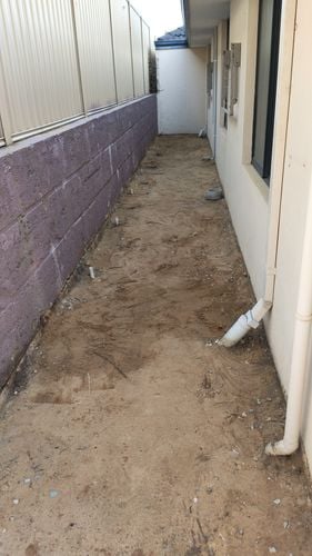

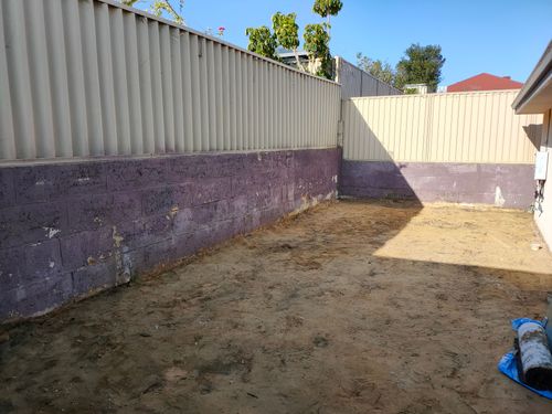

I am currently doing some backyard renovations and have a reconstituted limestone that has been previously painted running along my boundary. I have thought about rendering, repainting or trying to strip the paint off. I am open to ideas. I am aware the paint may have seaped into the limestone but it appears to be chipping off at certain areas.
Thank you for your assistance.

I would suggest that it's next to impossible to remove the paint from the porous surface. Unless you adamantly want to render I would recommend preparing the paint by removing any that is degraded and repainting. Grab a wire brush and scrub down the area where the paint is flaking. Remember to wear appropriate PPE including a face mask, safety glasses and gloves. Then, scrub the whole wall down with Sugar Soap and a stiff bristle brush. If you have a high-pressure washer, that could also assist in blasting off loose paint.
Once the area is prepared, apply a primer and a quality exterior paint.
