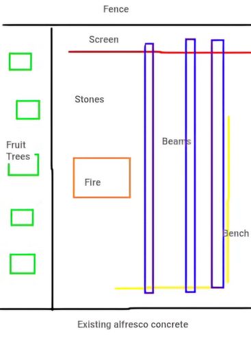

Thanks Dave I love the suggestions, just trying to picture in my head is this what you're suggesting?
I apologise for the late night MS PAINT knockup done on my phone LOL hopefully it's clear if not please let me know and please correct if I've misinterpreted anything in my picture from your suggestion

hahahahha Love it @Calvin91
Almost what I meant but really its doable as well. :smile:
One set of beams behind the Right hand side lounge to give tha "wall" a top and for lights to hang from.
The fire pit towards the middle but longer and thinner.
maybe a couple less trees.
But really you have nailed the description :smile:

Oh thanks I think I got it.. So do you mean also have posts in the ground on the right hand side of the bench? But then the left side is open so don't the beams have to run from alfresco towards fence as in my picture as the left side will be open facing garden bed?

Yes the posts are in the ground, 3 or 4 all up straight along the back of the lounge with a top beam/rail that attaches them all together to the privacy screen. The fruit tree side is open. You could do the same on the fruit tree side but I thought it may look a little busy/cramped. I am thinking a clean straight line along the rear fence, straight up the side of the back of the bench seat and then along the back of the house (just attachment points for the light along the back of the house) To give a three sided outside room. If you want i can try and draw a pic of it later today. :smile:
Take the most right hand purple beam in your sketch, imagine the posts directly underneath it. Loose the other two left purple beams. The beam is only a cap to the posts, it dosnt go over the seating area at all.
Or if you like what you have drawn you can go from there, tho posts will be needed at the rear of the house if thats the case :smile:
