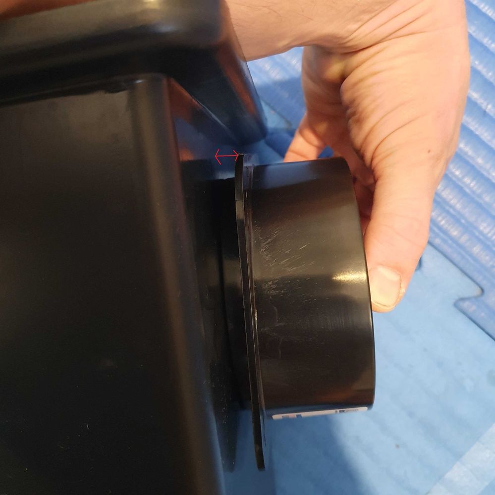

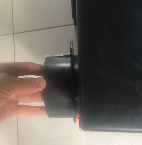

I just want to clarify something you said: "the circular section does not pass through the hole". The circular section you are referring to is the shorter circular side of the pit boss connector, right? I will try illustrate the question with a picture:
The red arrow is the circular section you're talking about?
Is my picture above how it is supposed to sit in the end (with silicone and screws)? Does that mean the hole in the pit wall has to be ever so slightly smaller than the inner diameter of the circular section? To prevent the circular section from sliding in?
Cheers,
Denis
Re: EasyDRAIN Pit Boss Connector correct usage
The hole in the pit wall needs to be ever so slightly larger than that smaller circular section @denisl. That little bit goes inside the hole, making it a flush fitment of the flange. The larger circular section doesn't pass through the hole, and what I was talking about.
Sorry, I didn't realise there was a small circular section.
denisl
Thanks very much again @MitchellMc , that clarifies everything for me :smile:
