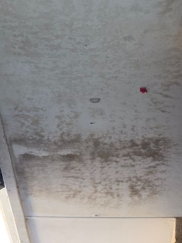

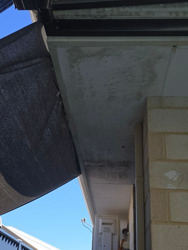

Can you please tell me what causes this, how to fix it and prevent it? Also happening at the front
Re: outdoor gutter
Hello @lilnikoy82
It's possible that water has settled onto the top part of the soffit and has caused mould to start growing. You'll notice that it is only happening where the down spout is, and it could be an indicator of a leak in that section. The only way to tell if there is a leak is to remove that section of the soffit and doing a thorough investigation. Because the mould has been there for a while it has started to travel towards the metal gutter.
Once the leak has been addressed, I recommend changing the soffit and not reusing the old one so that you will not run the risk of mould spreading further. The gutters outer surface can be cleaned using 30 Seconds 1L Mould Off. Please make sure to rinse the surface with clean water once the mould has been cleaned off.

Good Evening @lilnikoy82
My thoughts are a little bit different from @EricL 's but still end up with mould appearing from moisture.
At first I thought that the water was curling under the gutter and onto the eve area due to the shadecloth (Still think that this is helping with the issue of mould. ) I am not sure as to the front of the house mould point but maybe the gutter is full and the water is curling over the gutter and under the edge to end up back under the eve. With the Photo you have shown I think I can see an instantaneous hot water tank up near the eve, if thats the case then potentially warm air rises from that, travels along to that point and working with the moisture/collecting because of the shade cloth helps form mould.
I do like @EricL's suggestion as well. Both come back to a water coming from somewhere.

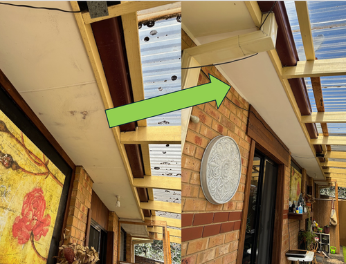

The photos below show an example of an eve I restored with this process a few weeks back.
Hope that helps. Nailbag

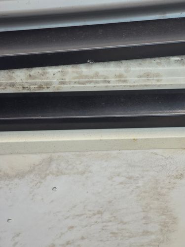

Thanks for replying, just a few things, there is a down pipe right where the mould is forming. I got up last year and looked but couldn't see anything blocking the down pipe and even ran the hose down it with no issues, the shade cloth has only been up for this summer and the unit in the background is the air con unit in a terrible spot.
So I'm at a loss as to what's happening. The house is only 10 years old. The front one is really bed and it settles in a corner spot which I think is because there is no downpipe there? I can add photos for that tomorrow as it is pretty bad.

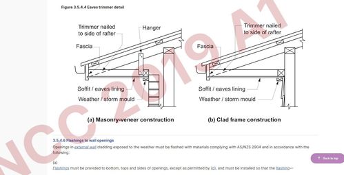

I just googled terms and came across this pic in the building code that shows what I suspect is happening.
https://ncc.abcb.gov.au/ the diagram is right at the bottom of the page
You can see an example of the eves profile on the left. For mould to form I would be thinking water is gaining entrence from maybe a leaky tile, water curling under the gutter from gutters being overfull in storm instances. @Nailbag explanation works really well for breaking down the issue.
If water is entering via the tiles or curling then a likely spot for it to pool after running down the timber trusses is on top of the eaves/soffit. This moisture then migrates through the material and can introduce mould. Alternatively, if water curls under from the facia (I know mine does in extreme storms) it can also introduce that wet area and then mould is quiet happy to make a home.
