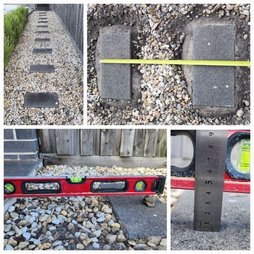

I’m planning to redo my stepping pavers and pathway because:
1️⃣The current pavers (400x200mm) are too small for my liking, and I’d prefer larger tiles (600x300mm).
2️⃣The pathway wasn’t laid with landscape fabric, so now the pebbles are sinking into the sand and getting messy.
Here’s the challenge:
The existing pavers are sitting on large concrete blocks (big mortar bases). There are 10 of them, and I really don’t want to remove them all—it feels like a massive job! 😅
Also, each paver is 4–5 cm higher than the one before because my house sits higher than the street. Around the porch, it’s about 40–50 cm above the first paver (closest to the street).
Here are my questions:
1️⃣For the pavers:
Can I place 600x300mm tiles on top of the existing concrete pavers? If so, are there any tips or things I should be careful about? I don’t want the last paver (closest to the front door) to end up higher than the porch—will 4 cm be enough for a 2 cm tile plus mortar?
2️⃣For the pebbles:
How can I stop the pebbles from sinking into the sand?
Do I need to redo the entire pathway by removing all the pebbles, adding new sand and landscape fabric, and then putting the pebbles back? Or is there an easier way to fix this without tearing everything apart?
Thank you in advance for your advice and tips—I really appreciate your help!

This is a final work. It is not perfect but I have learnt a lot from this project. Thank you for all suggestions and guidance. You guys have helpes this project a lot.
Re: Tiling Over Concrete Pavers and Stabilising Pebbles?
Morning @ty2
That looks great! Minimal impact to the surrounding area and you have completed it nicely
Any pointers you would tell another person doing the same type of project?

My steps are on a 7-degree slope, and I recommend anyone with steps on a slope to download an app that measures slope angles. This helps ensure that each step has a consistent slope and is set at an appropriate angle for safety and comfort.
