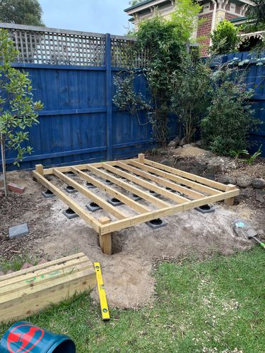

Thanks everyone for the super useful responses. I’m pleased to say that we got the posts in last night alongside the pedestals. All seems to be ready for starting to lay the decking, except the weed matting which I’ll have to add tomorrow.

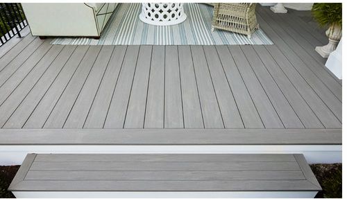

I’m hoping for the final product to look something like the attached picture (in the same colours). If you’ve any advice on how best to achieve that type of professional finish it would be really appreciated. I’m currently planning to use treated pine and simply paint the white and greys. I did look into using prefab boards like Ekodeck, but they seemed to be comparatively much more expensive.
If you’ve any thoughts about how to install spotlights into the stairs that would be amazing too. Thanks!

You most certainly can paint the pine decking panel; however, I recommend letting the pine panels season for at least six weeks to let all the tannins out of the pine timbre. You can shorten the waiting time by using Intergrain 1L UltraPrep Tannin And Oil Remover.
In regards to your decking steps, I suggest having a look at these discussions - Merbau patio step by @edwardjones. It's basically a miniature frame with decking panels on it. You'll notice that they anchored it to the ground with the same 90x90 timber post to make sure it does not shift or move when stepped on. How to build a back door step? by @Jolly181 and How to build front yard tiered decking steps? by @frediynewbie.
