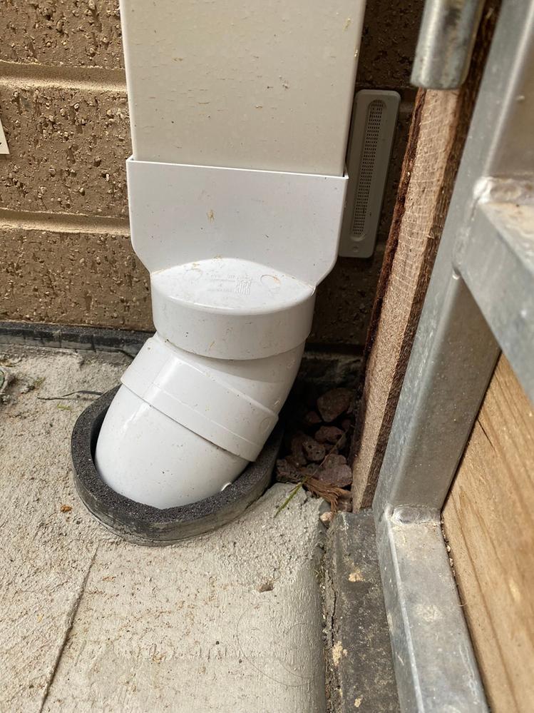

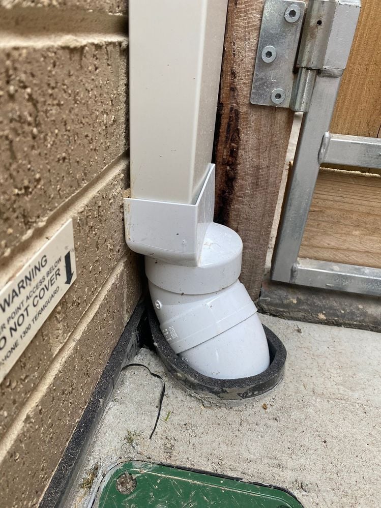

Hi team, Can you tell me the best way to put a stop to the sound of water dripping down my downpipe and hitting the elbow. It's right outside my bedroom window and once the rain stops it can drip for ages. Slightly annoying when you are trying to sleep! I've read things like gluing a piece of sponge inside the elbow. Is this what you would recommend?

Thanks Eric for your reply. I will grab a ladder and have a look up there, but I highly doubt that it is from debris or anything as this is a new build in a new estate and there are no trees around whatsoever. I have only been in the house for five months, and have only noticed it since the weather is starting to get a bit wet. I believe it’s just the fall of the water when it hits the bottom of the elbow. I will see if I can find another solution. Thanks.

Investigating the cause is the best way to find out why the dripping is occurring. The only other thought in my mind is the way the down pipe has been angled. If it is off center and is leaning, odds are that the water is getting to the edge of the dropper and is falling off it instead of flowing onto the downpipe. But the only way to find out is by having a look and testing it with your garden hose.
