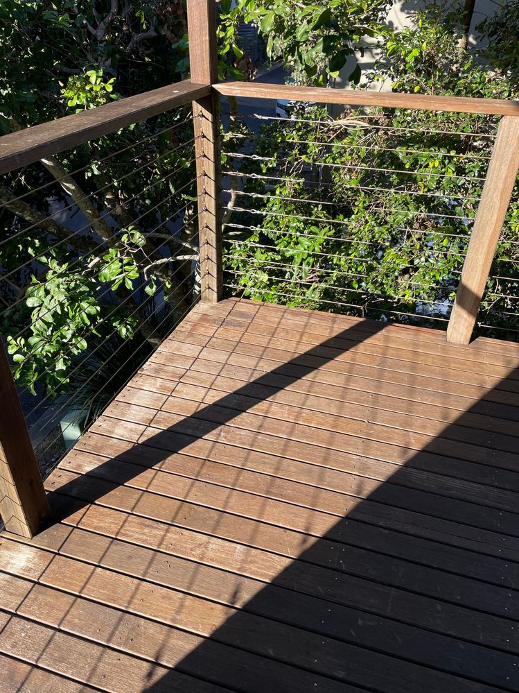

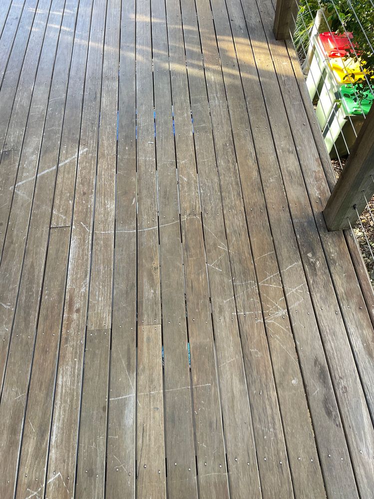

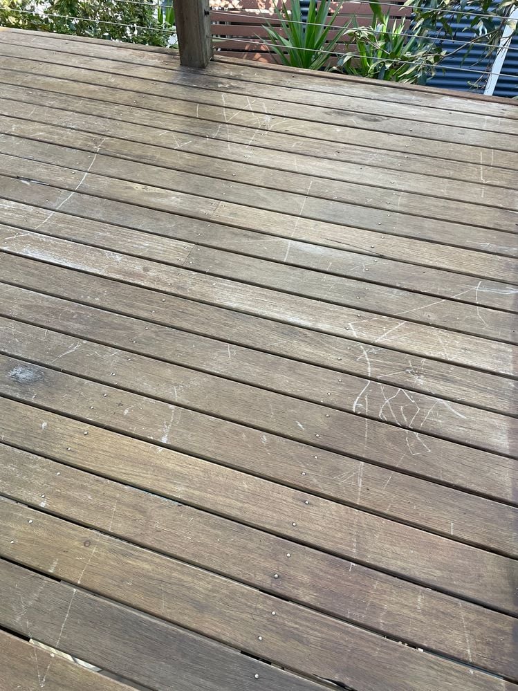

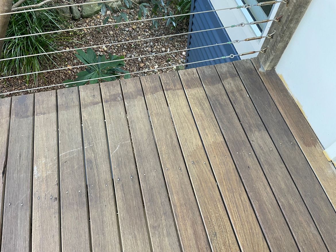

I recently bought and moved into a house with a 5m x 3m timber deck on the upstairs floor (the carport is directly beneath it), and the deck looks like it hasn't been taken care of very well, it's looking weathered with grey and thirsty looking areas, uneven and patchy staining, and has several scratches from furniture and possibly a dog.
After looking at posts on this site and others, I thought I might be able to get away with just vigorously cleaning with Intergrain Deck Cleaner, and then apply 2 or 3 coats of Intergrain Deck Stain (in Merbou colour).
However after doing the clean the other day, the deck looks even worse for wear, and the scratches and patchiness of the previous stain are very apparent (see attached images).

In order for the stain to properly penetrate your timber decking, it will be necessary to sand the entire surface of your deck. I'm aware that you are not after a full detailed revamp, but I'm afraid it will be necessary to do a proper sanding of the surface, or you will get a patchy finish on your deck.
I suggest hiring an Orbital Floor Sander along with a Floor Edger. This will remove all the old stains on the timer surface. It will be necessary to punch in all the nails on the deck to prevent tearing the sanding pads on the sander. As for the posts a detail sander should be enough to remove the old stains without having to remove the wire balustrades.
