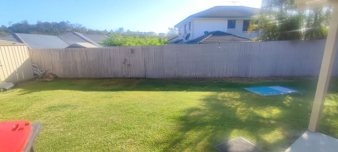

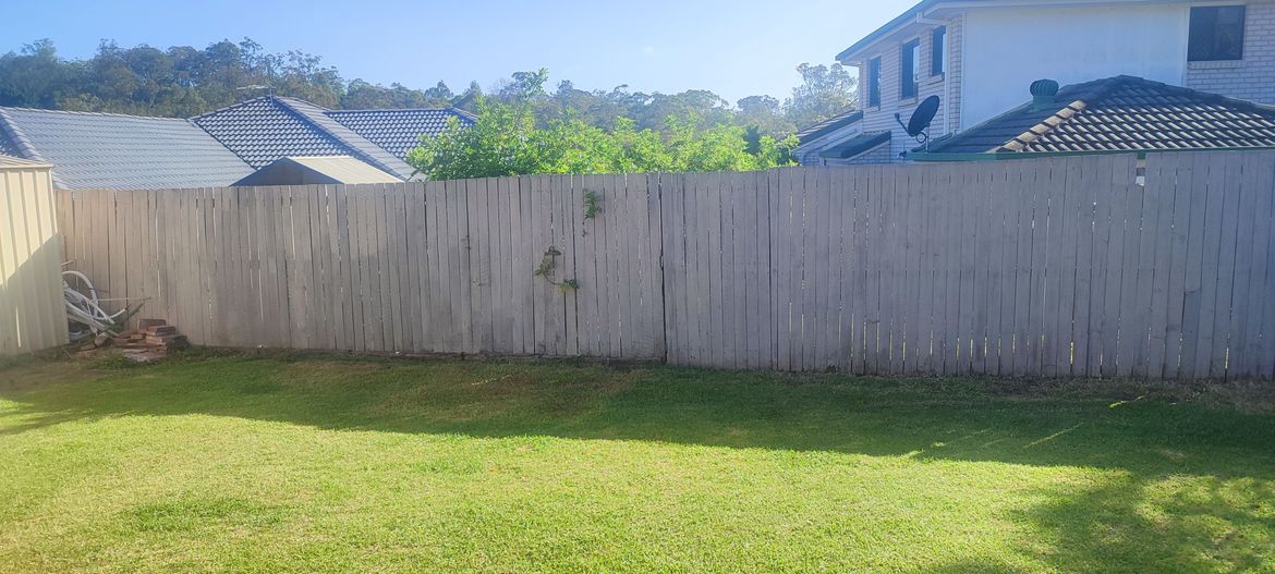

I would like to make my house fence look beautiful.
Currently, its timber fence palings and its around 15 years old and starts falling apart slowly.
I would like to give it some sort of plain texture which I can paint easily. Height of the current fence is about 1.7 metres and the fence rail is facing my neighbours side. I am having some time off during Christmas break and would like to get this done.
Please suggest me your valuable ideas.

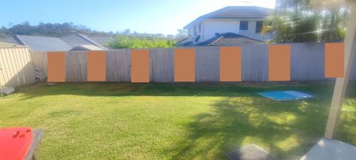

I would like to make it plain ....like putting some fibre cement sheeting over it and paint it ... When I search it online so many different types of cement sheets pop up.... Just need some help choosing correct material for this task.... Also do I need to run timber rail on my side of the fence to install/secure the cement sheeting ? I am clueless at the moment.
Please advise.

It's great that you've received excellent advice from @Jewelleryrescue. Placing fibre cement sheeting in front of your fence is one option. However, if the posts and rails are already weak, it will not be good for the structure of the fence and could cause it to tilt. But if the fence framework is still in good condition you have a few options open to you.
The first is to use cement sheeting, the rule for choosing cement sheeting is to make sure that it is rated for exterior use. The second is to cover your fence with another product such as an 1800 x 902mm Pre-Oiled Merbau Alternating Slat Fence Panel. This will give your fence line a new look and make it feel more organic rather than just a plain flat fence. The third option is to put up a new fence or replace the fence pailing with new timber.
From a fence-pailing perspective, I would estimate the replacement at just $30 per meter. This is from what I can estimate from the picture you posted. Please keep in mind that whatever you choose to put in front of your fence, the current fence must be able to hold its combined weight. I recommend speaking to your neighbour and asking them if you can inspect the fence posts and railings.
