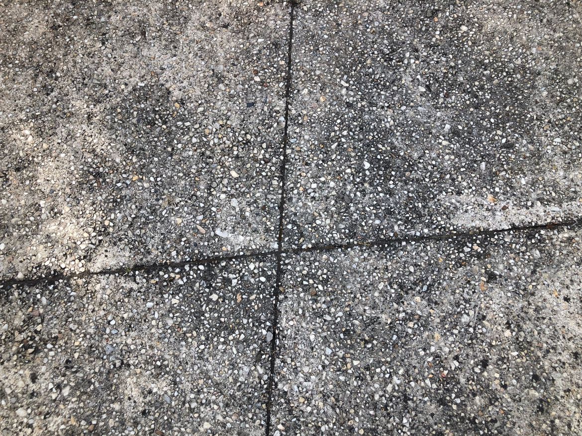

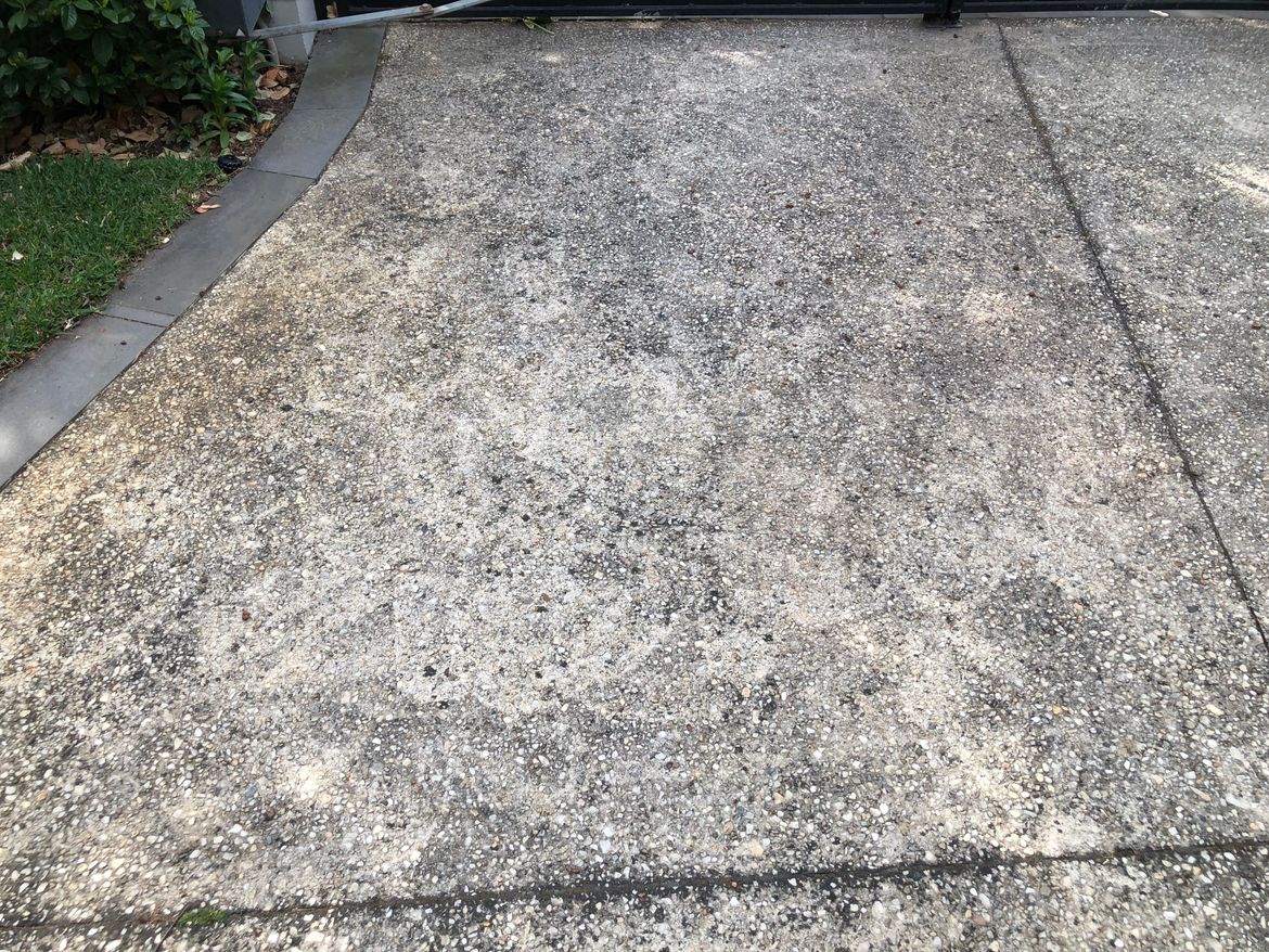

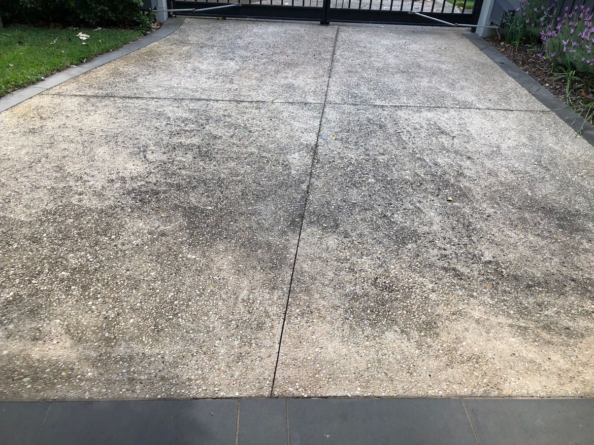

Hi, my pebble mix driveway has deteriorated over time. It looks washed out and stained. It’s probably 23 years old. Don’t want to pay a fortune to have it done again plus it’s not really in need of replacement. Any ideas to restore it? Thanks so much.

Good Morning @katiemaroo
I recently used a water pressure washer to do a section of my concrete driveway. Just because I had acess to one and I was cleaning some paint off my patio so it was a case of try it and see. It came up surprisngly well. If you have a hich pressure washer (mine was gifted to me from aa friend and he had bought it from Aldi) It really was strong enough to remove everyday dirt . Just took some time.
The surface looks like its still nicely attached to the concrete. There are no points that have lifted? If there are none I would suggest to have a go with a water pressure washer, at least for a first step.

Sorry for the delay in my reply, @katiemaroo, and thanks for those images.
As @Dave-1 mentioned, your driveway looks to be in a reasonable condition, and I reckon it will look very nice after a cleaning. A pressure washer with a patio cleaning head like the Ryobi 1800W 2030PSI Pressure Washer would make this job a breeze. The patio cleaning head allows you to cover large surface areas easily and won't have so much of a tendency to blast the little stones out of the surface like a jet nozzle. Since the area looks like it has a significant amount of growth and debris, I recommend applying 30 Seconds Outdoor cleaner before pressure washing and then again after you have finished. This will help remove some of the staining that the pressure washer can't.
I'll be keen to see how your Pebblecrete comes up after a decent clean. Please keep us updated.
