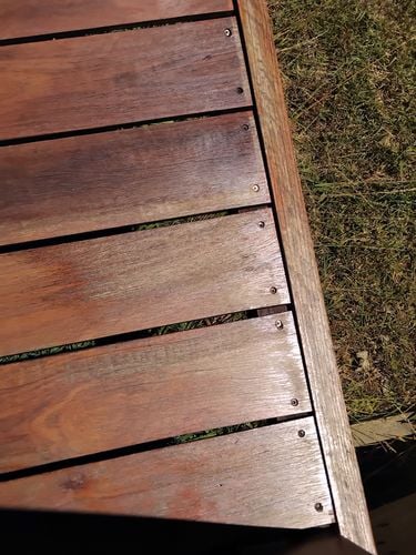

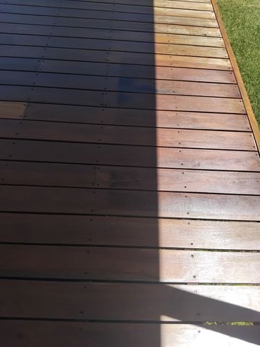

sun exposed areas and bbq mat stain

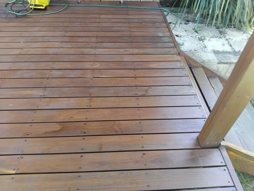

most of deck in good condition

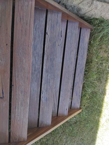

sun exposed area dry deck

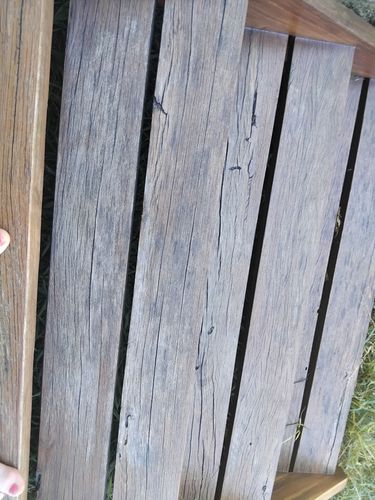

steps in worst condition probably need sanding
I tried re-oiling a small part of the sun exposed weathered deck boards
to see how they came up, they don't look awful, but darker and less colour than the better preserved boards.
I've decided to sand those areas

I'd suggest staying away from any chemical strippers unless absolutely necessary. Sanding is usually the best way to go. If there is still staining after sanding, you can address the stains on a case-by-case basis.
Ultimately, the best way to get an even coat is to sand back the entire deck and reapply the oil, however this is a lot of work. You should be fine just sanding the worst areas and then reoiling everything.
