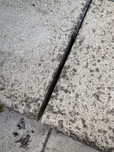

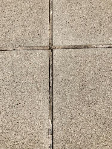

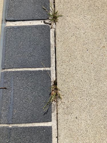

I need to do some re-grouting on the outdoor tiles around my pool area. The grout has some cracks and is starting to let in the weeds. I also have a couple of spots where the grout has fallen out.
Are there products that I can go over the existing grout rather than grinding away and starting again?

Hi @MichaelE,
Going over the degraded and damaged grout would be considered a band-aid repair. It could be successful and might give you several years before needing to be done again. Typically you'd want to remove the degraded areas and resolve the issues which have caused the cracking to occur. The cracking and separation are due to movement, and that is why the joints in pavers are so often filled with sand instead of grout.
For the areas of missing grout, it would be best to chip out any adjacent grout that is loose and remove it. You can then patch the area with a mortar tinted to the correct colour with oxide. For the areas where the grout has separated from a paver on one side yet is still in good condition, you'd be best filling the crack with a flexible filler like Mortafil. Mortafil is highly flexible and will cope better with movement than a cement-based product.
