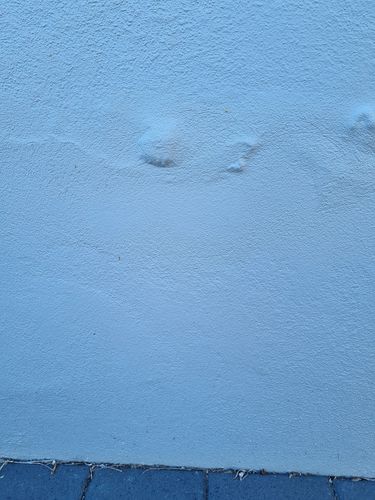

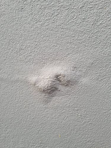

The exterior render around our hose keeps bubbling and breaking up. We have had it repaired several times but it keeps happening. The chap who has repaired it advised us to use brown vinegar to wash away the powder that comes through the paint (efflorescence?). We had a quote to repair it at $10,000 with no guarantee it would work. We don't believe there is a damp course - is this possible? There is no interior damp. We are on a hill on clay soil. Any permanent repair ideas??

Hi @JulieW , this is an external wall looking at the photo? can you do a bigger photo of the area so we can get an idea of what we are looking at.
Exterior efflorescence isn't that uncommon and can be caused by external influences like sprinklers etc?

In the absence of a damp course layer, water can enter the wall and push the render off through hydrostatic pressure. Is it just the lower portion of the wall that is affected?
Some exploratory work likely needs to be done. You could chip away at the worst area and see what that reveals. If the wall is damp behind the blistering render, that's the cause. You'll then need to investigate further to determine how the water is entering. What's on the other side of this wall? Is the ground level higher than what we see here?

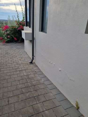

Yes, an exterior wall, also the interior wall in the garage. I'll post some more photo's later. There are no sprinklers that touch any part of the house and we don't have water sitting anywhere on the ground around the house. The render bubbles and cracks off eventually.

Hi. Yes, down the side of the house, the inside floor is higher than the outside as the ground slopes down towards the front of the house, although it happens at the back of the house too where the inside floor is at a normal level. When the render has been removed (about 4 times now!!), there doesn't seem to be any damp and there are no signs of damp inside the house. The chap who has repaired it said it wasn't prepared properly when it was originally done but I'm not sure about that as it is in a line around the lower part of the house, not all over.
Re: repairing external render
Could the soil under the house be up against this wall and above the damp course line, @JulieW? That wouldn't explain the rest of the issues on the other house walls, though. It is slightly unusual that the majority of the blistering is lower to the ground. That would typically infer that moisture is rising to that level.
If you are sure there is no moisture in the wall, there must be another reason for the render delamination. If you were to have the lower section re-rendered, I'd certainly recommend considering adding render mesh. It's an expanded mesh that helps hold everything together.

My husband removed all the blocks that butt up against the wall and we put course gravel down before replacing the blocks just in case it was a drainage issue.
Were these blocks under the house @JulieW? I was more concerned about the difference in soil level and whether the soil under the house and behind this wall was above the damp course line, typically 150mm from the bottom of the wall.

the side of the house slopes downwards and the render bubbles in a line approx 40-50 cms above the paved area.

We aren't sure that there is a damp course - is it possible that there isn't one? I've tried to get damp proof companies to come out and see what they think, but can't get an answer off anyone. I'm reluctant to pay to have it repaired for the 5th time for it to happen again.
