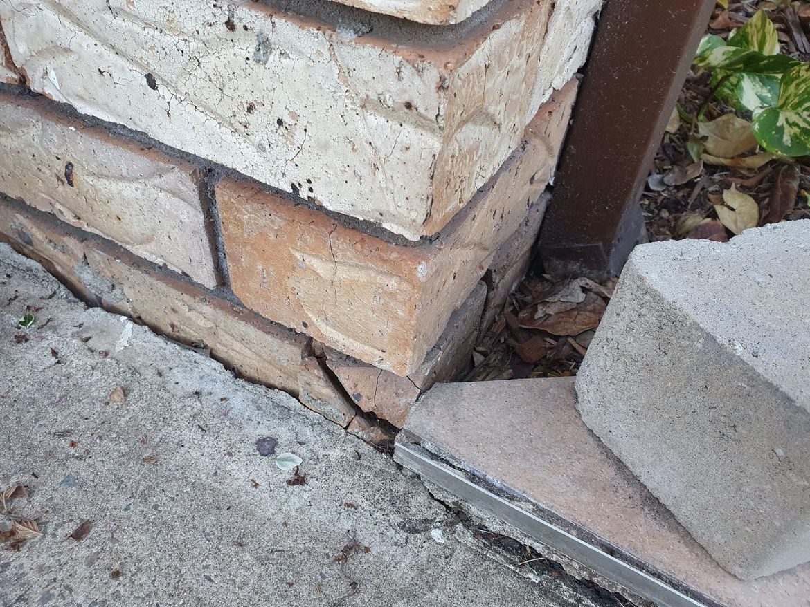

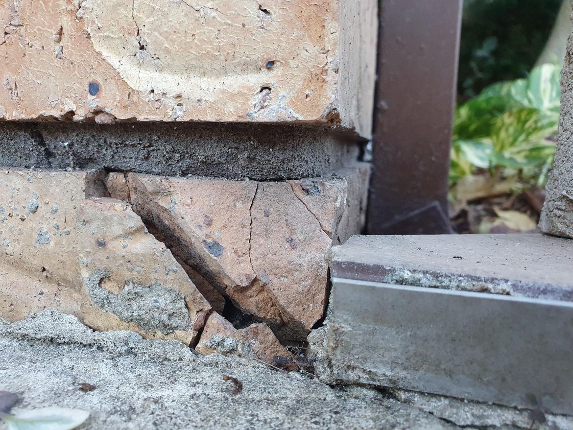

Hi All,
New here. I found the a broken brick at the bottom corner of the house. I am thinking chisel away the small pieces as I am not able to take out the some pieces at the moment. Put some liquid nail in and then apply quick set mortar. Not sure if it's the right way to do. Any suggestions ?

Welcome to the Bunnings Workshop community @Lyney. It's terrific to have you join us, and many thanks for your question about repairing a brick.
Your method sounds like it will work, but there is likely no need for the Liquid Nails if you are using mortar. If you'd like a fairly unnoticeable repair, I'd recommend you mix some Dulux Avista Oxide 1kg Sandstone Cement Colouring into the mortar.
Alternatively, you could use Selleys 415g Liquid Nails Landscape Stone Concrete Adhesive to stick the broken pieces back into position.
