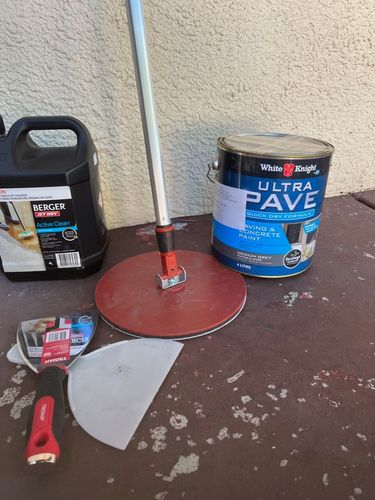

then I’ll Berger Active Clean it and ain’t with white knight Ultra Pave quick dry 2x coats.

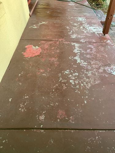

1- image shows close up spot where I’ve sanded de-flaked.
2- image 2 is the area I haven’t sanded yet.
3- is the tools etc.

When determining whether your current efforts will suffice, it's essential to remember these concrete paint products are specifically designed for application on bare concrete or a previously painted surface that is in good condition. To the best of my knowledge, the Rustoluem concrete paint is the only option suitable for a deteriorated painted surface, albeit with limited colour choices. Other brands do not provide a warranty for their products on this type of surface due to the risk of potential delamination and subsequent peeling.
Based on my personal experience and other members' successful endeavours, I believe the paint will adhere perfectly fine. However, the durability of these coatings can only be determined with the passage of time.
I recommend gently running your fingers over the sanded areas. If you cannot detect any noticeable transition between the residual paint and the underlying substrate, chances are you won't perceive any inconsistencies when applying the topcoat. However, I suggest further sanding if you can still feel the painted sections. Just remember to prioritize your safety by wearing a face mask and safety glasses during the process.

Typically there is no primer used with the White Knight Ultra Pave @jhb, so there is not one that I could suggest. It sounds like you are doing a good job at sanding the surface and etching so that should suffice.

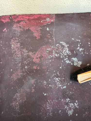

Hello! It’s taken this long to get a week without rain. I originally did this post in May it’s now end of September- do I need to sand/ active clean again?
alao how long should I wait between spraying it down and painting

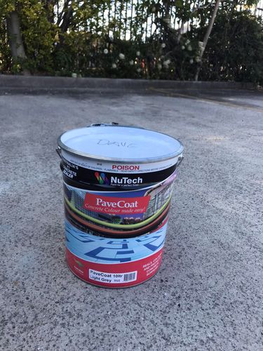

I looked into the types of Bunnings paint for concrete and paint from outside Bunnings. I ended up going with an industrial paint by Nutech. (Both Bunnings and Nutech would be about the same price tho the difference was a multistage process (Bunnings) or just a recoat (Nutech). I ended up with 10L of paint of which I used maybe a Third with two coats. It really doesnt look like it needs a third coat.
My patio looks pretty much like yours, instead of sanding I used a wire brush attachment to my drill to get rid of any leftover bits of flaky paint.

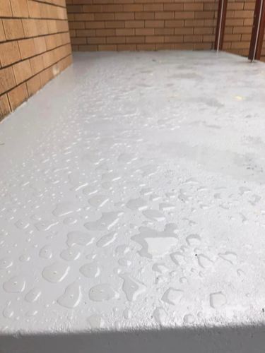

The one issue that showed up was the new paint over the old paint seemed to lift the old paint in some areas. I had three patchs of new paint lift, easily fixed with a paint scraper and for some spots I wasnt sure if I had brushed it with the wire brush so cannot say 100%
The paint went on easily enough and really seemed to penetrate the non painted surface well. The painted sections came up nice. The recomendations was a totally dry surface, between 10-30deg C and no rain plus not earl in the day or late due to potential dew.
It rained about 3 days after the painting, I did the coats a day apart and prob pushed it closely to the 30deg upper limit. The rain beaded nicely and the surface is not slippery at all.

Hi @jhb,
Active clean is really for tough stains from oil and grease. Nothing would have changed on the patio in that time, but you'll need to give it a wash down to remove any contaminants that have built up over that period. If you are happy with the appearance and smoothness after the original sanding you can proceed with painting after cleaning.
The surface must be completely dry before painting, so best to wait for a few days of warm weather to dry it out before painting.
