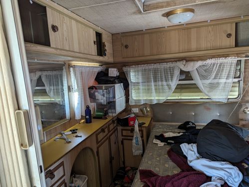

I am renovating a caravan for my teenage son. I have never renovated anything so have no idea. I have ripped out half the caravan and have found some floor damage. I'm happy to do whatever it takes to get it right. I just want to know if when replacing and finishing do I do the floor or walls first. As I was removing damaged walls I noticed that they go under the floor... Which would be easier. And what material would I use to replace floors and walls. Any help would be appreciated.

It really depends on the extent of the damage and how much of the floor and wall need to be removed for the repair. If there is substantial decay in the floor, you could be looking at entirely removing the floor and the walls that sit on top of it. If it is just a small section that needs repair, then you might get away with patching here and there. If you can provide some images of the areas you'd like to fix and the damage, then members like @twocutekelpies will have a much better idea of what you're working with, enabling them to make some helpful recommendations.

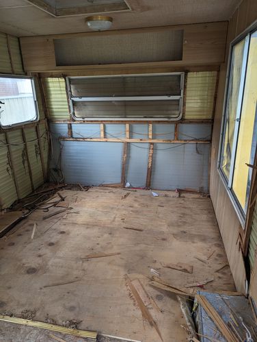

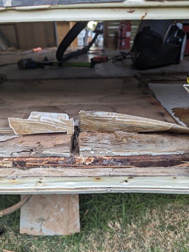

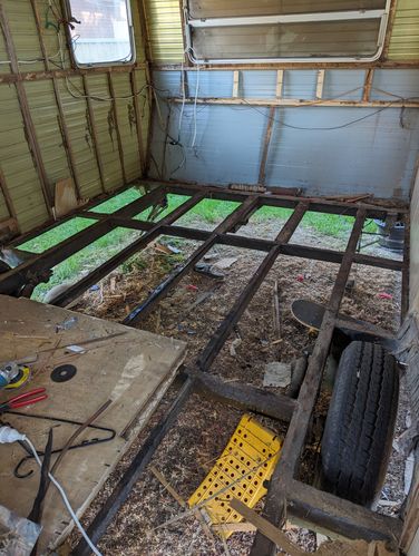

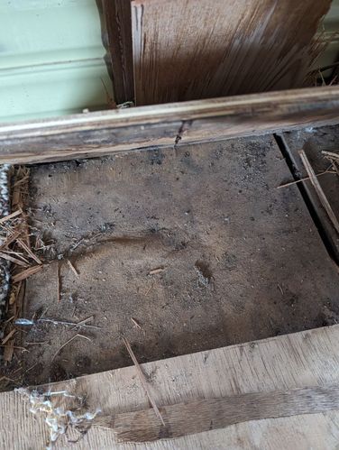

i have removed all the walls . Damage was pretty bad. Only parts of the floor are damaged so hoping I can do patch ups. Floor is unlevel in parts to so obviously I want to level it out before laying floor tiles.I just don't know what to use to replace floors

Typically, plywood is used for floors, and you'll need to measure the thickness to determine an appropriate replacement. Ensure you thoroughly waterproof the underside so no water can penetrate.
Re: How to renovate a caravan? Floor or walls first?
Hi Michele. Is this caravan going to be going on the road at all? I notice in one of the photos that there is quite a bit of rust on the chassis, might be worth exploring further. Especially look under the walls where they connect to the floor, the "z channel" is notorious for rusting out and causing separation. The z channel isn't something that can be bought off the shelf but any metal fabricator/sheet metal place can fold some up and possibly install for you.
You're lucky that the floor doesn't go under the walls like some caravans, it makes it easier to replace. Most use 12mm ply sealed with something like Bitumen Paint underneath to protect from moisture, any thicker ply will be too heavy, any thinner will be too bouncy. If replacing just a section, make sure to line up the joins with sections of the chassis that will support your joins.
If you lift your floor out, it's a great opportunity to clean up, rust treat and paint your chassis. I put mine up on car ramps to give me better access underneath and not wear so much paint.
If you're handy with a router, you can create an overlap join between your pieces of ply, again making sure the join is supported by a section of your chassis.

So I've ripped the bad floor up and next weekend will be bitumen painting the chassis and wheel arches thanks to @twocutekelpies who commented on my post. (Really appreciate it). I'm excited about this project and would love tips and ideas. Thanks in advance

I never even thought about asbestos 😲. My bad. The chassis looks rust free. Next weekend I will prep the chassis for the bitumen paint. I will no more about the rust situation then. But all in all it looks in pretty good shape ☺️
