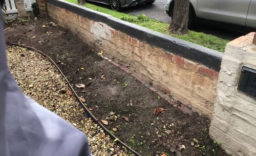

I would like to render this rough bagged wall. I have watched the Bunnings how to video but was wondering if there were any tips and tricks that would help with my project.
I will use Davco off white render and then paint. Should I add bondcrete to the mix? How do you get a sharp edge over
the rounded brick top?

Thanks for sharing your question about rendering your low brick wall. It's great that you've seen the guide for rendering. I suggest using a pressure washer on your brick wall in combination with a bristle brush and detergent. This will give your wall a clean surface and remove any loose material on the brick wall.
I'm in total agreement with your plan on adding Bondall 1L BondCrete Cement Additive. Not only does it add bonding strength but enhances sealing properties as well. My best advice is to mix only what you need during rendering. In this manner the mixed render will not be sitting out in the open too long.
