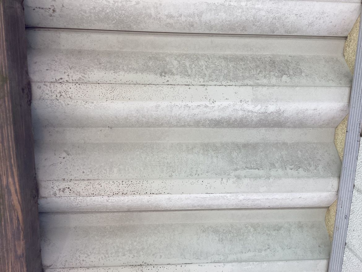

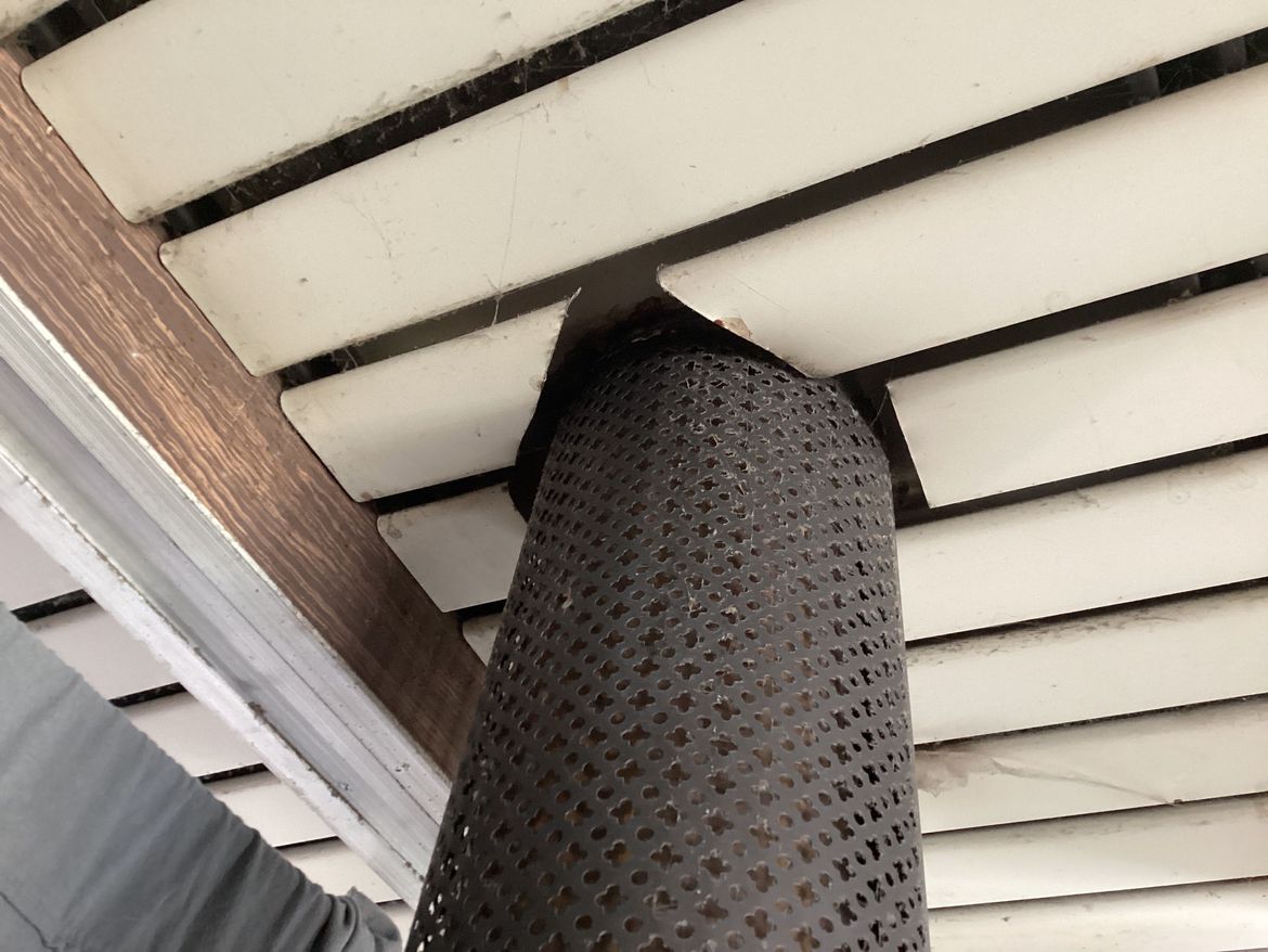

Do you have a photo of the top of the chimeny going through the roof?
From the underside if I look closely it seems that the outer edge fits the metal roofing. The white pieces are decorative? I would be thinking of a large metal cowl for the underside to cover those cuts.
The top I cant really comment. 😕 I do think it will be problematic sealing the top of the silver tho (waterproof wise). Will wait for a photo if possible.

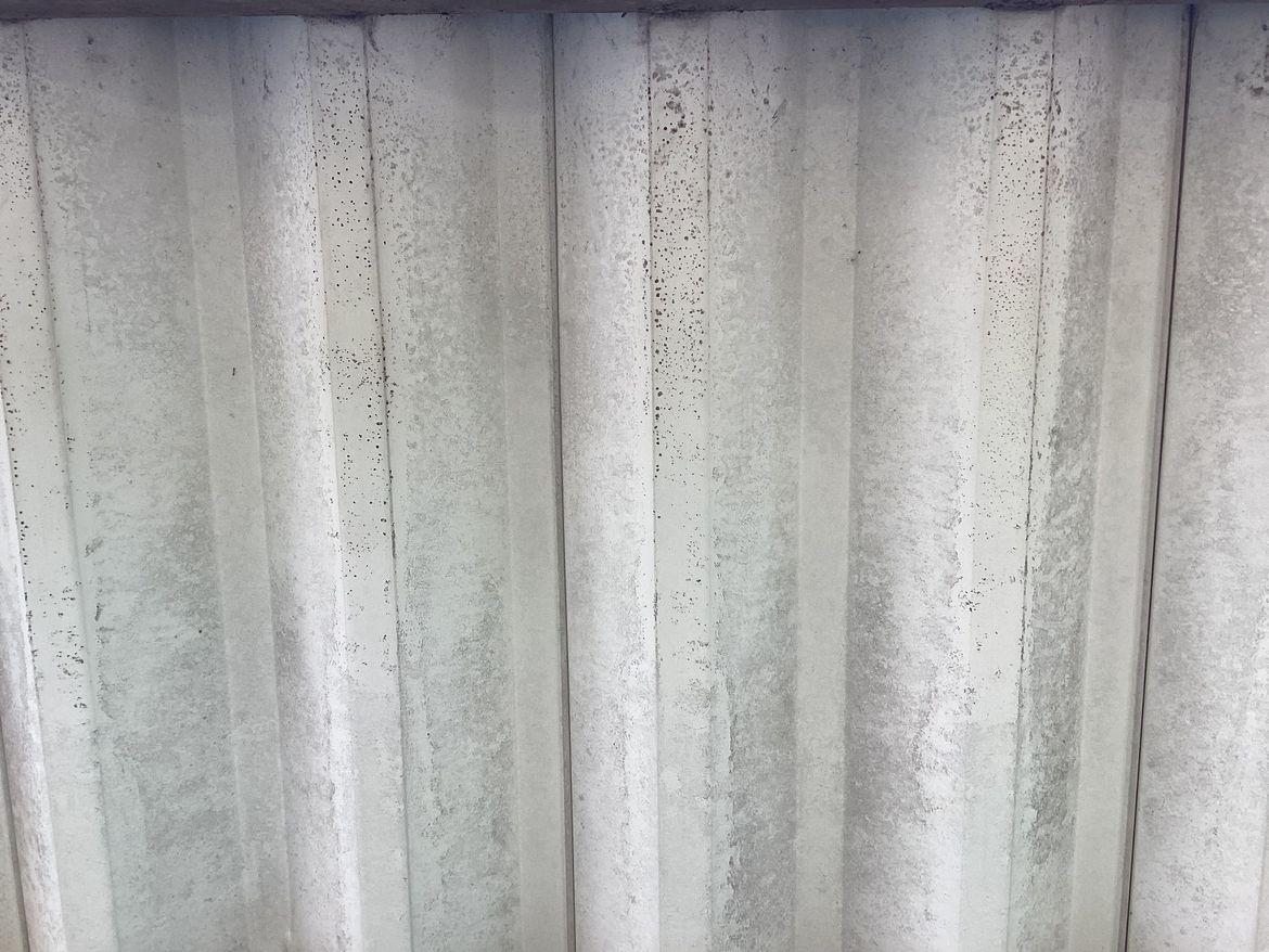

Thanks @Dave-1,there was/is insulation between the white slats and the roofing sheet that was cut out for the hole for the flu pipe the top photo would only show the rubber boot holding the outer pipe for flu to the roofing sheet,as diameter of hole is size of inside chimney pipe to be smaller,reason I can’t use a piece of original sheet is the hole is too close to the joint in sheet to get a reasonable water seal therefore looking at a paint on product of recommend choice,Hoping to not confuse,roofing is in good condition with no other issues,I was thinking of temporary taping under hole,painting top,remove tape under when dry and painting/sealing remainder,not sure what product would suit and stand up to weather and UV rays,Cheers Glenn.
