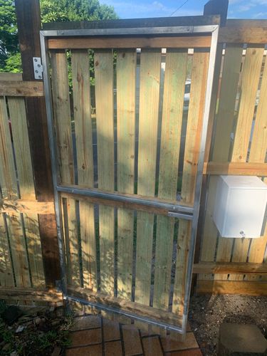

Hi, have just had a timber fence put in and the front gate has a metal frame with timber cladding. Will be painting the timber with Dulux Weathershield but wondering what’s the best way to paint the metal gate frame?

Welcome to the Bunnings Workshop community. It's sensational to have you join us, and thanks for sharing your question about painting your galvanized gate frame.
In order to paint a galvanized surface, I suggest washing it first with Selleys 1L Wall Surface Cleaner Super Concentrate Sugar Soap. Please note that this is a concentrate and must be diluted down before use. This will remove all the oil and grease contaminants that are on its surface. Once the frame dries off, I suggest using the White Knight Rust Guard 300g Grey SLS Etch Primer Spray Paint to prepare the surface of the galvanized frame. For the topcoat, I recommend choosing from the White Knight Rust Guard products they can be tinted to match the colour of your Dulux Weathersheild paint. I don't advise using Dulux Weathersheild on the galvanized surface as it will not adhere properly.

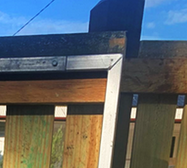

I was looking at the top right mitre - is it welded? Or is it a 'shark fin' cut - bent together and pop-riveted?
Hard for my eyes to tell.
Cheers.
Re: how to paint metal gate frame
Hi @Noyade,
It appears that it could be one of our Fortress Gate systems. They have fully welded joints.
Thanks mate. Then that's a very good looking product for the price!
