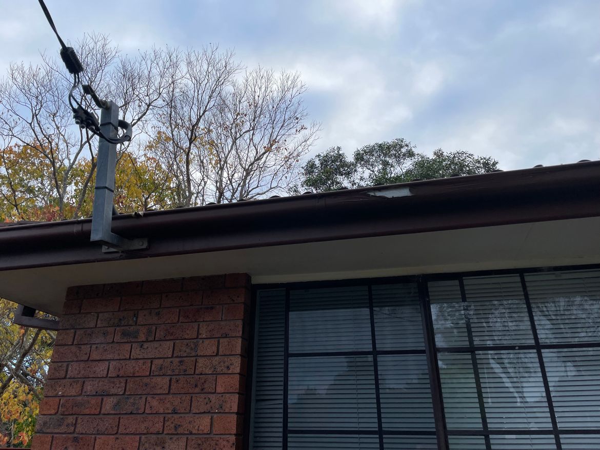

Would like to paint my gutters, what would be the better way and what do I need?

It appears that the paint is delaminating and peeling away from the guttering. You can see this is also occurring on the far left of the guttering. Since this doesn't appear to be an isolated area, the correct approach would be to remove the current paint from the guttering before priming and then recoating with good-quality exterior paint.
I can't tell from the images, but is this a previously painted gutter or galvanised steel? If it is galvanised steel, I would suggest removing any loose paint with a scraper and then, if there are some well-adhered sections, apply a paint stripper to them. However, if this is a Colorbond gutter that has a painted coating, the stripper would likely remove it too. In that case, you might be best off not using the stripper and removing all the brown paint with a scraper.

I understand that removing the current paint likely doesn't sound appealing, but it's the only way to guarantee your new paint doesn't continue to peel off with the older paint. It's not recommended to paint over compromised surfaces such as this.
