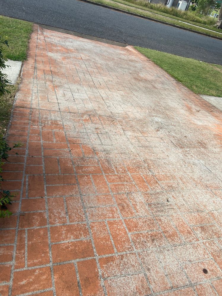

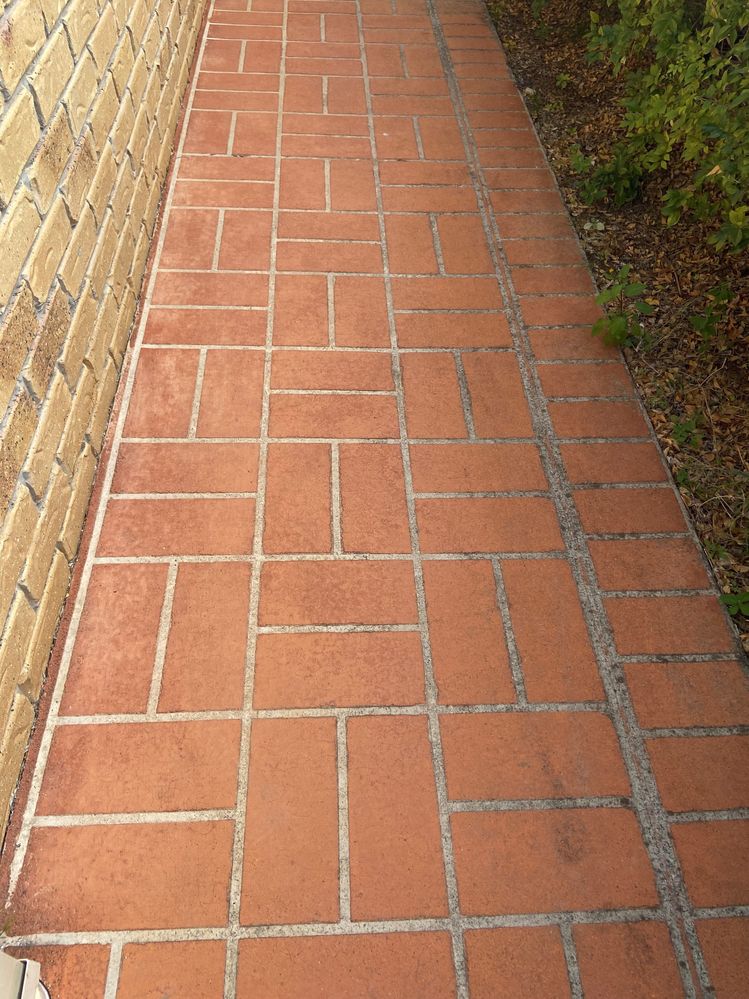

What is the best way to paint a stencilled driveway and outdoor areas pls?

I thought I'd add that concrete paints must go over a porous surface like bare concrete or an un-degraded previously painted surface. The products used must be compatible if it is over a previously painted surface.
Typically, stamped/stencilled concrete gets sealed to prevent staining. This sealer is not porous and prevents the paint from adhering to the cement base. This means that your painted coating will only ever be as strong as the degraded sealer underneath. If the sealer lets go, then so does your new paint topcoat. That's why concrete paint manufacturers don't like warranting their products over non-porous surfaces, sealers or degraded surfaces.
After you acid etch, I'm sure that driveway will have little to no sealer left on it as it's already worn back through the paint layer. That pathway could be a different matter. After you acid etch it (which hopefully should remove any remaining sealer), do a water droplet test on it. If, after 15mins, the droplet has absorbed into the path then you are good to paint. If it's still sitting on the surface, then it's not porous, and the paint will have trouble binding to it. Our concrete paint suppliers recommend that you strip the sealer off before painting.
