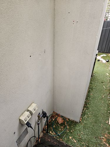

Hi, I purchased a 20 metre Gardena retractable hose.
Just looking to mount it on outside wall, which is Besser block with render on top.
The mounting bolts are pretty long...
Do you think i can just drill and fasten straight into the Besser block? (noting that it is hollow inside) will that be strong enough?
Or do I need to find a stud in the wall and fasten one side into that?
I've tried to find a horizontal timber support in the wall, but I can't find any
Photo of location attached

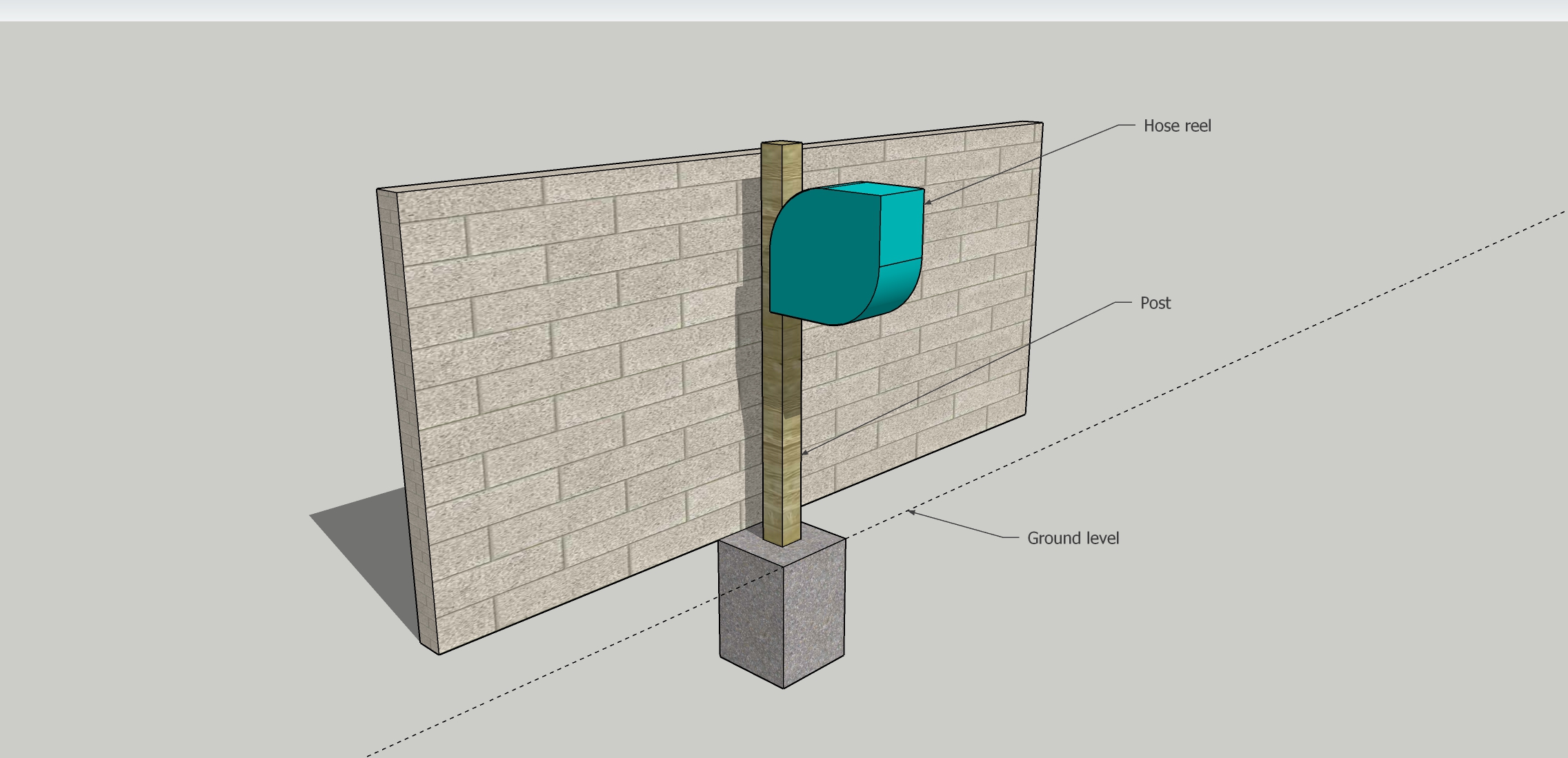

Hello @stanley44
It is possible to anchor your retractable hose to the Besser block by using the following kit:
Ramset Chemset:
However, due the dynamic forces being applied to your hose real there is the possibility that the hose reel will come off or at least destroy its anchoring point. I suggest instead installing a 100x100 post with a concrete base. This post will be able to handle any dynamic forces the hose reel may apply. I've placed a sample image below to give you an idea of how it can be done.
