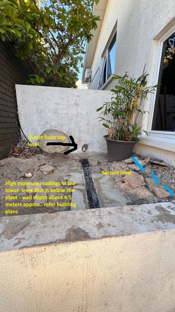

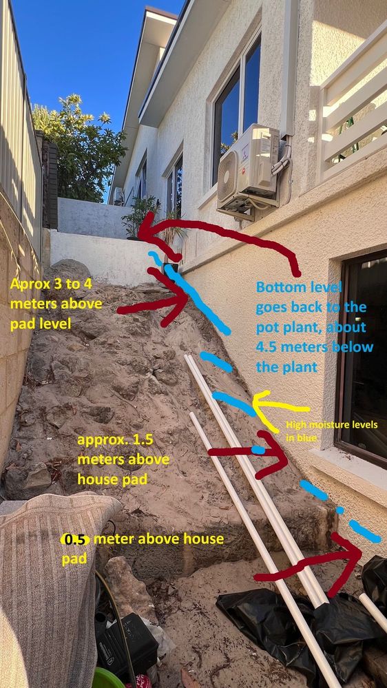

Hi Everyone,
need help with a solution for a steep site down the other side of our house, causing high moisture readings in the walls.
Very sandy and has a layer of limestone rocks that are not cemented in.
I've partly removed the rocks  planning to remove the rest.

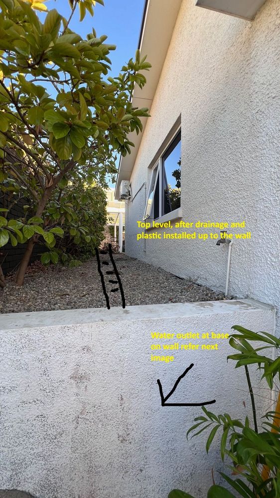

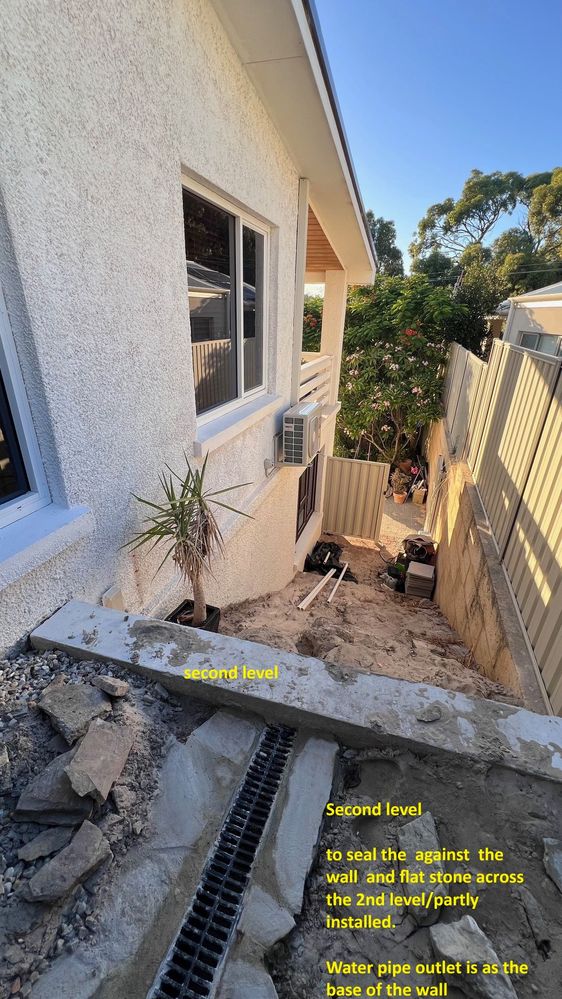

Top two level sections - installing drainage solution with existing and new plastic and covering with existing stones. Water will be piped down the slope. (refer images)
But what to do with the slope.
My concern is anything I do will be a temporary fix and then break down, eg plastic liner ripping.
The source of the water is all surface and want to stop it going into the ground and move it all to the front of the property.
Planning to take out all the stones, remove some sand from the left side, to create a slope away from the house.
Relay the stones and cement all the stones to create a seal/hopefully keep the sand dry.
Against the side of the house: I don't want to put stones right up to to the side of the house/damage the wall,  plan to have a gap of a few inch's and fill with cement with water proof additive,  then a bead of sika.
What I've suggested sounds okay or anything else you would consider?
Would you cover the whole site with plastic before laying the rocks?
What plastic is not going to rip apart and if I did put a plastic down, it would help the rocks slide down in time/crack the cement?

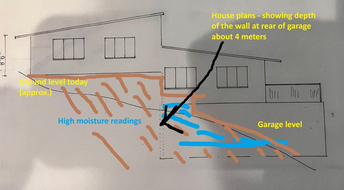

Would be nice to seal the house wall but its too deep, 3 meters or more at the top and at the bottom 1.5m to the pad. ( no existing seal from what I can see - build in 1975 approx)
(The other side of the house is similar - but has already had the rocks cemented, with multiple crack repaired over the years and I will be repairing as recommended in the forum with sika along the edge)
Thankyou for any suggests that can help me fix this challenge.

Do the second and third photos show the top of the slope or the bottom behind the location where you were standing to take the first photo?
Where are you experiencing the most moisture in the wall?
Is the existing black plastic coming up from under the concrete footing of the house?
Where do these drainage channels expel water?
Is the aim to emulate the slope on the other side of your house that can be seen in your post titled How to seal cracked retaining wall?
If so, I would start by, as you've mentioned, excavating the sand on the left side of Image 1 so that it slopes away from the house.
I would then add a thin layer of drainage gravel, around 5-10mm thick, over the sand and compact it with a tamper. This thin layer is there to help lock the sand in place and prevent erosion.
I would then lay builder's plastic over the slope and add a thicker layer of drainage gravel, around 50mm thick and once again compact it with a tamper.
You should then attach 10 x 100mm Abelflex Expansion Joint Filler Foam to the wall so the top edge is in line with where your mortar will go. This will act as a protective barrier to prevent damage to the wall as well as cracking in your mortar from expansion.
You can then relay your larger stones over this compacted base using mortar mixed with Bondall Silasec Waterproofing Cement Additive, ensuring you maintain the negative slope away from the wall.
Once the mortar has dried, seal the edge to the wall using Sikaflex Pro+ Polyurethane Sealant like you planned to do on the other side of the house. This sealant should be applied over the top of the Abelflex.
