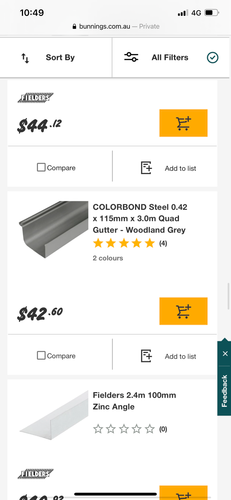

I’m interested in buying 2 of these gazebos and want to join them together as it’s way cheaper then buying a 6m long gazebo
I’d like to know if anyone has joined the two together ? Or has any idea how to join them without water getting through

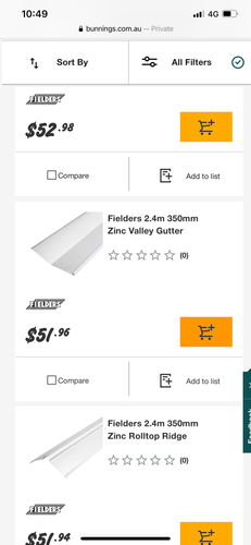

I’ve been looking at quad gutter and if that will be a good idea
