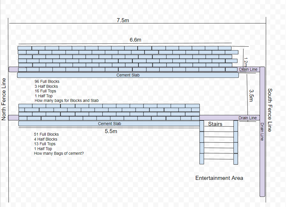

In order to determine the number of blocks and amount of mortar you'll need for the wall, could you please let us know the length of the wall that you'll be creating?
It sounds like you are on the right track. Your sloped string line is throwing me a bit, though. Is that a separate one from the one you've described that is level and for establishing the level block base?
I see you have road base under the drain coil. The drain coil needs to sit on the soil, or the water will run through one wall and out the other side instead of being carried away. Also, there should be road base directly above the drain coil so the water can drop through it and into the coil. You seem to have a layer of soil above. You'll see what I mean in this helpful step-by-step guide: How to install garden drainage.

I was going to work out the number of materials I needed, myself, once the rain has gone and just working out my approach for this job.
Yes, you are right the string line should be straight across for a measurement to the ground.
The drain coil is in front of the wall with the limited draw ability in google draw.
Should the concrete base of the block wall be lower than the drain coil sitting on the ground?
I will make the changes you have pointed out and show soil under the drain coil, the measurements of the string line, and approximately the materials needed, soon.

I have measure up the yard.

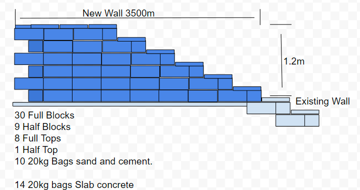

I will lay a wall across the yard, 6.6m, and then at a right angle extend the wall for another 3.5m along the neighbors fence line to the existing wall.
Across the Yard
The boundary fence joins a step existing Besser block wall 3.5m
The drain line runs across the yard and down th3 boundary fence to the underlining storm water pipe.

Hi @Kvic
Thank you very much for the update on your plans. My only recommendation for this project is to add two extra full blocks just in case you have accidental damage while installing the blocks.
Please keep us updated with your progress, we look forward to seeing the start of your drainage project.

Hi @Kvic,
Will these walls retain soil? If so, they'd likely need engineering, especially the first 1200mm high one.
Here's a helpful step-by-step guide on How to our a concrete slab. You'll also find these calculators handy for calculating how many bags of concrete you'll need for the slab and how much mortar you need for the blocks.
Re: How to improve drainage?
Most of these walls will be mostly uncovered but I could included rebar and filled with cement where the block height is over 3 blocks or more but I don't feel it will and may find that I could remove a couple of rows from the top, on all walls, when laying.
The north fence is the highest at 460mm which is less than 3 blocks high and then it drops away so most of the wall will be 1 or 2 blocks.

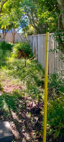

The neighbor's fence line drops very quickly from the 1.2m and most of that wall is not supporting the ground and is why it is stepped to run along the property ground level as does the old block that it will be attached to.
The same goes with the other shorter block wall that goes from the north fence to the steps.
North Side Fence
Neighbor Fence Line and the yellow post is the 1.2m

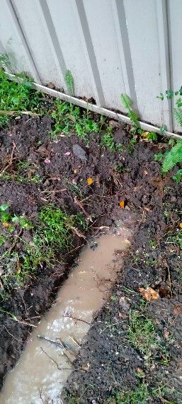

So I checked out the weather for this weekend and saw the rain was coming next week so l started to dig out my across the yard drain pipe channel, pick and shovel style, very heavy going with rocks and roots but I did make a good mess of it and then the rain came.
Channel
Other end
So the channel filled up with water and I hadn't open it up to the south side of the fence. I open up the south side channel to flow down the property.
South side fence line.

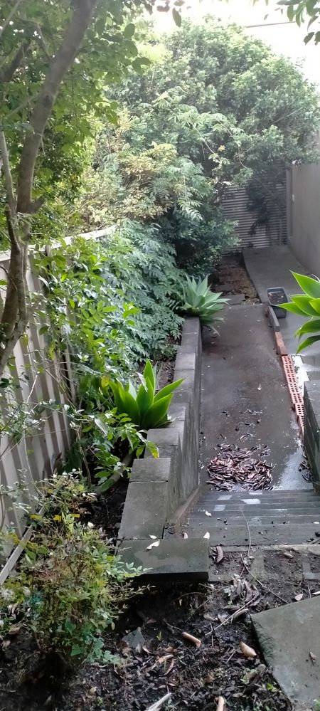

The water from the channel runs down in between the Besser blocks and fence. Currently or the reason for putting in a drain was to divert the water coming out from under this stairway and flooding the lower court yard with water and mud.

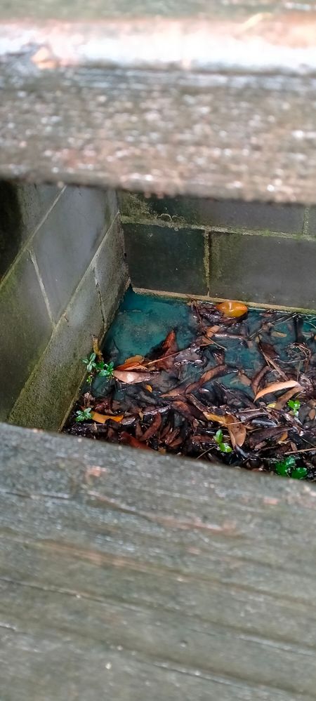

Under stair case
So the water flooding in the channel is seen here coming out from or still coming out from under the stairs and interestingly along the south line fence.
