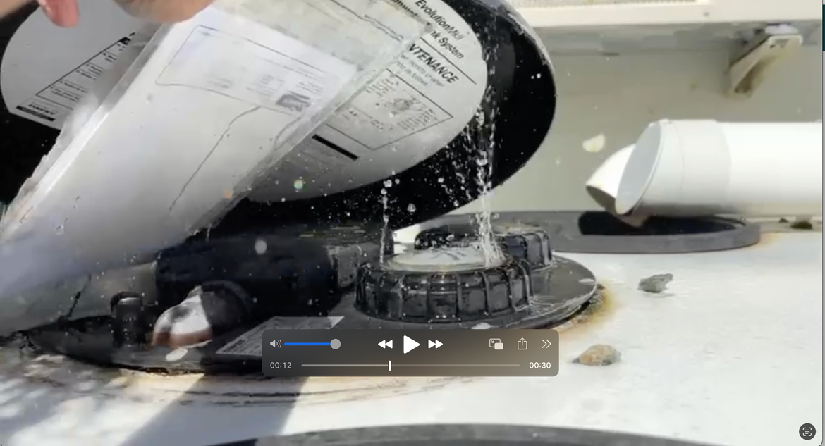

My rainwater tank shows leakage/ or blockage issues as the base is always wet. Upon inspection I found this issue where water seems spurting out from top . This happens if rainwater is used inside for any reasons. What could be the underlying issue and how can I troubleshoot this. Thanks

I presume that's likely the pump unit and that screw cap has a sealing gasket that has failed. The pump is pushing water out of it when operating. It looks like you have some documentation there and likely a good lead for contacting the company that manufactured the unit to provide troubleshooting for your issue. Provided the issue is just a failed gasket, the remedy could be as simple as unscrewing the cap and replacing the gasket.
