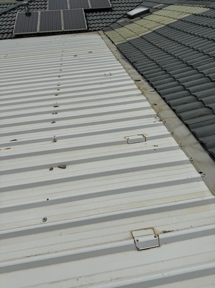

I've been given options to 1) replace the whole roof or 2) to remove the screws and replace with metal patches and refasten with new screws to the ribs.

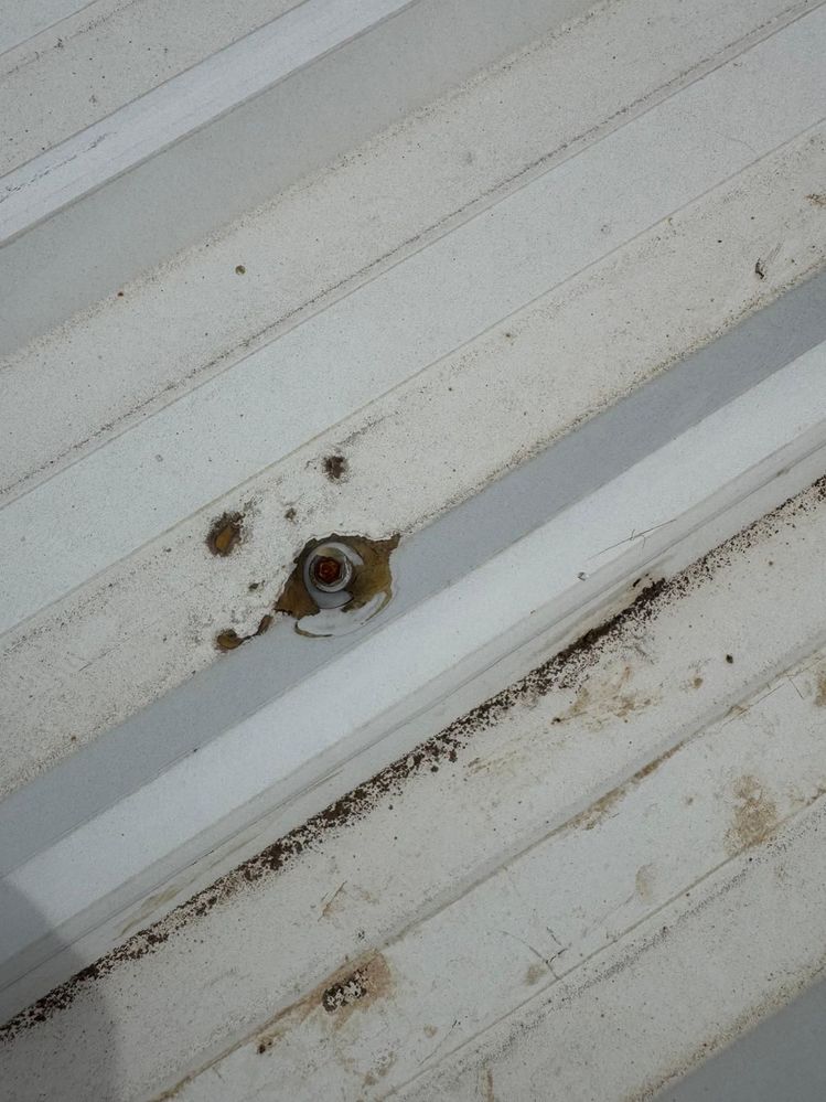

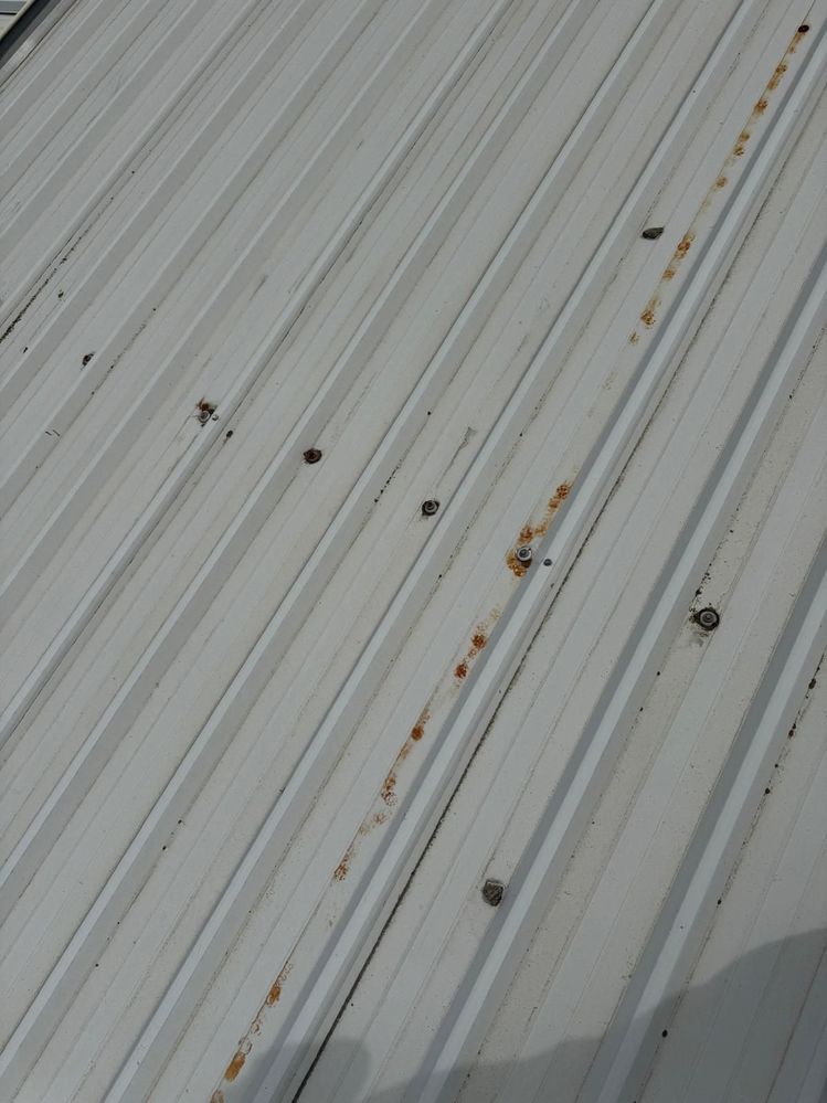

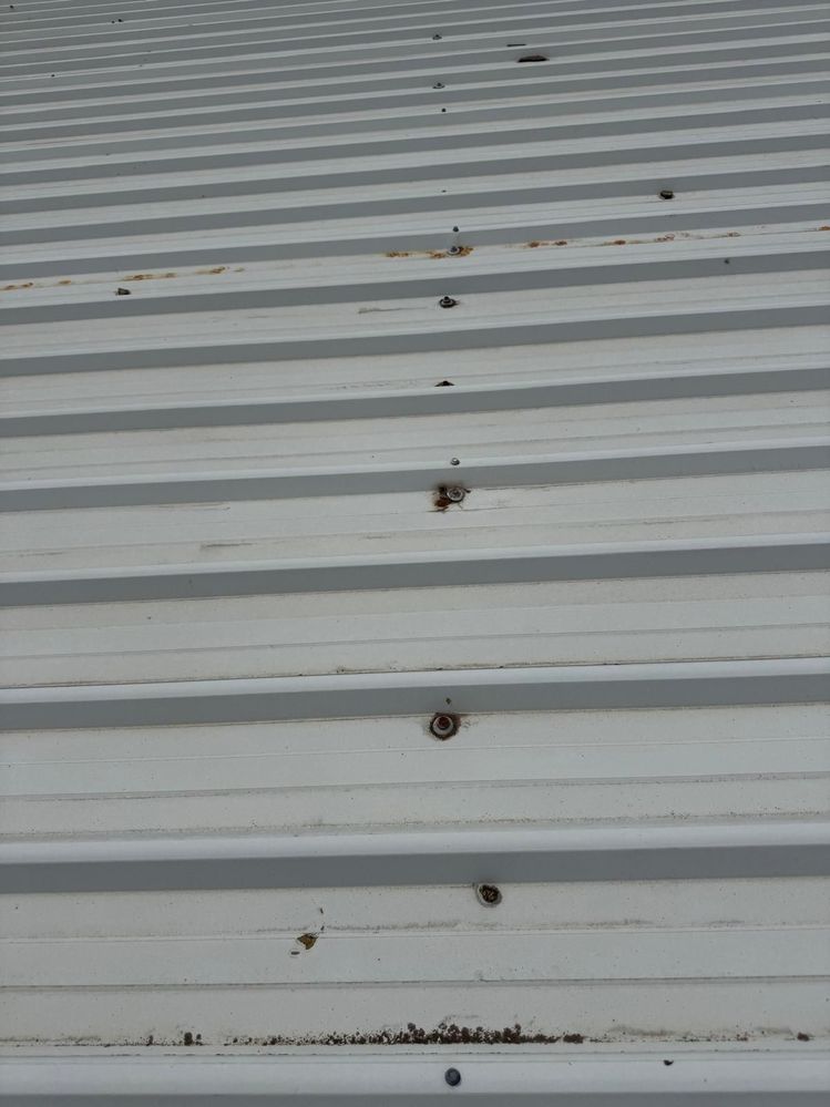

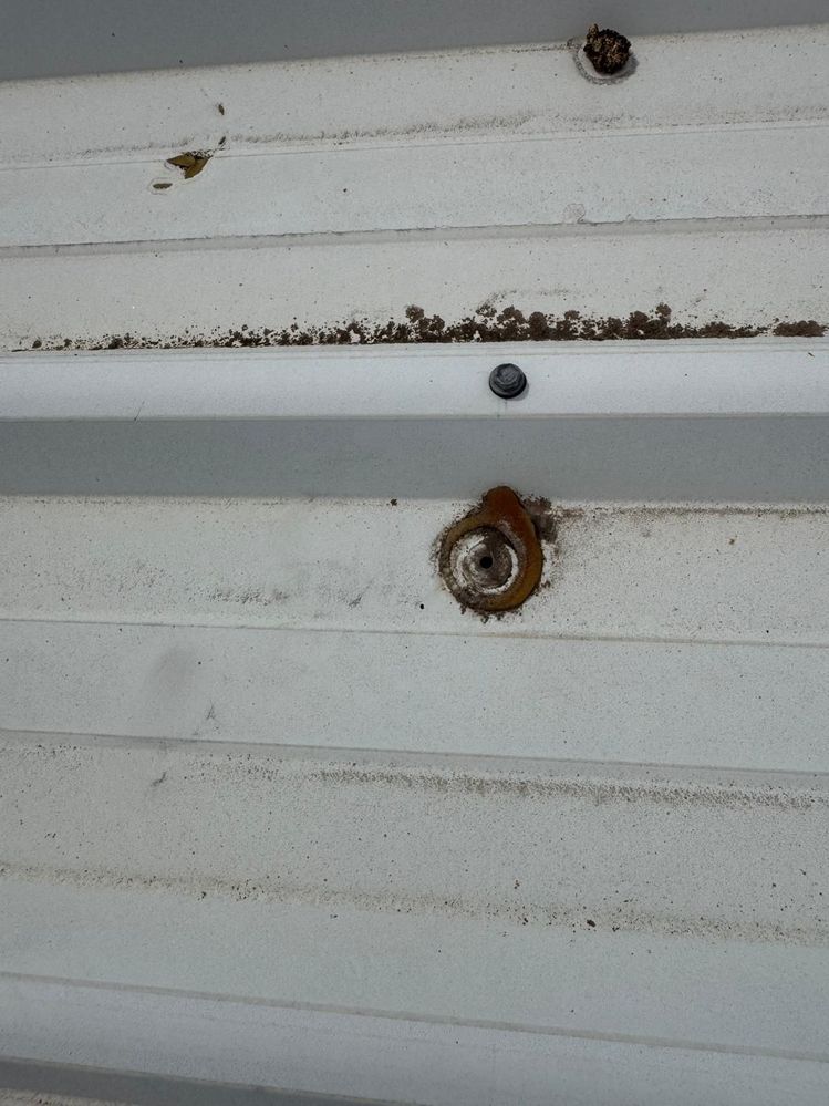

I've been told the roof screws have been installed wrongly on the pans/valleys rather than the ribs/ridges. And some of the rubber rings around the screws appear to be cracked. And one of the screws is even missing.

screw with cracked rubber
screws in pans instead of ribs
roof has existing patches
missing screw

The position of the screws is relative to the location of the installation and the profile of the sheeting used. This profile of the roof sheet is referred to as Trimdeck, and in a roofing application, the screws should go through the ridge, not the valley. You can see this in our supplier Lysaght's Trimdek Brochure.
With this being said, a roofer may be able to give you a solid repair that will last a good amount of time, but ultimately, they are working with materials that weren't installed correctly to begin with, so the repair will only be as good as the initial installation was.
Personally, I would be looking to replace the roofing materials, but I am not the one who has to bear the cost of the repair.
My advice would be to weigh up whether you think you will get 1/6th of the expected life of new sheets out of the repair. If so, then it is probably worth repairing. If not, then replacement is the best option.

That is a pain, Short term I would go for a repair with silastic and flat squares of metal to cover the old screw holes. (Silastic in the hole and around it, then plate pushed down so the silastic forms a solid bond on all four edges) You could do that yourself without a lot of trouble (Just make sure you only walk in line with the roof trusses as shown by the long run of screws. As you dont want to buckle the roofing)
At the same time as the plates going down I would be putting new screws into the ridges to secure the sheeting. Something you could also do if you are not concerned about heights. With teh screws dont overtighten them, they just need to be snug and the rubber compressed a little between the screw head and the sheet of iron.

We typically use Buildex 12-14 x 50mm Climaseal Hex Head Hi-Grip With Seal Roofing Tek Screws on steel sheet roofing.
I just wanted to point out that you have that type of screw in the ridges, but then someone has come along (potentially) later and installed a second lot of screws in the valleys. Why they did that, I'm not sure, but perhaps, there was some issue with the roofing they were trying to overcome.
