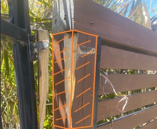

How to fix broken gate hinge?
Hi
any ideas how to fix this

Hello @kingj it looks like the hinge didn't have a sufficient mating surface, the 2 options that come to mind is to replace the timber OR glue & screw the piece that has broken away back to the gate and apply a square/corner steel plate to spread the weight of the top hinge over a greater area, additionally run long bolts through the entire post to also maximise the sharing of the weight/load.

Afternoon @kingj
Good suggestion above. Just a welding solution/idea from me.
Cut the tail off the hinge and weld a large piece of steel plate in its place. A piece that will cover most of the post width.
Re-glue the wood and attach the altered hinge. Just a hot day thought. 😁

Afternoon @kingj
The word "Ugh" comes to mind. Tho good news is its fixable.
Id reglue that broken piece just for looks as a first step. I would then more the hinge and reinstall it plus add another hinge in the middle or even two more hinges to make a total of 4. That should distribute the stresses. For that hinge that is near the cracked off section I would actually run bolts all the way through the timber gate side if possible. That will lessen the chance of the timber being ripped out again. (you could do it for all the hinges)

The broken piece is not strong enough , I ran a small nail through it and it got cracks ..How Do I add more hinges on the gate? I mean how to install on metal part.

Hello @kingj add more hinges the way they are already mounted (with tech screws), measure up the hinge and drill locations for metal fixing screws to secure.
BTW when attaching small shards/pieces of wood it pays to drill a hole to avoid it fragmenting....

Hello @kingj
My apologies for the late reply. It's great that you've received excellent advice from @DIYGnome, @Dave-1 and @Noyade. It appears that the two primary screws holding the weight of the gate has turned into a lever and split the timber post. I suggest using a multitool with a plunge blade and cut out a rectangular section of the post. I then suggest filling it in with an H3 treated pine piece cut to the size that you've cut out. I recommend using heavy duty liquid nails in combination with galvanized screws to anchor the repair piece in place.
Please remember to drill pilot holes to prevent splitting the repair piece.
In regards to the hinge, I propose changing it into a Pinnacle 70mm Fixed Pin Butt Hinge or similar. The mounting screw arrangement will spread the weight of the gate along the length of the hinge rather than just concentrating it into a single spot.
