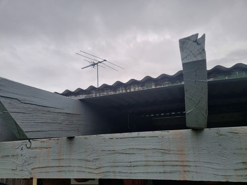

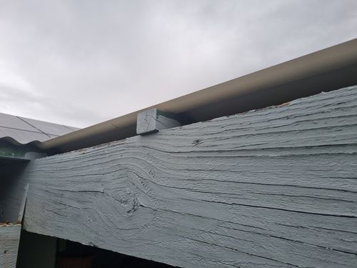

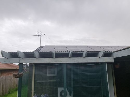

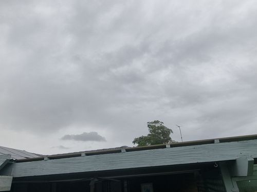

Hi guys, I am a newbie here. Looking for some ideas and suggestions to extend the roof of my pergola to prevent water entering during rainy seasons. Do I really need to extend the metal roof or is there any alternative permanent solution for the same.
Attached photos of the pergola

With the ends of the corrugated tin, you can slip short lengths underneath it to extend it out 500mm ish, With the sides, you can see the batten in the bottom picture. You could put in a few new longer ones(next to the existing one) that travels across say four of the beams and screw them down that way extending the side about half a width of corrugated sheet?
If you want to stop water coming in from the sides, then maybe some clear plastic blinds? Tho I like the shade cloth solution you have as it allows air to breath. Here is the type of blind I was thinking, you could roll it up for the rest of the year when not needed? Bistro Blinds 270 x 240cm 0.75mm Clear

Hi @samuelvk , I think @Dave-1 s suggestion is sound, but if you don't want to deal with short lengths of corrugated metal, you maybe able to use longer lengths of flashing laid along the timbers at the end... but this depends on how much more you need to extend out to cover, since flashing is limited in width to about 100 to 150 mm. You can get flashing with a small lip (abt 50mm) which I would place next to the batton, under the existing steel, such that it makes the flashing slope down towards the end of the roof, and the water will then run off. But slipping some corrugated iron under the existing roof (as Dave-1 says) will likely look better, especially if you have some distance to cover.
