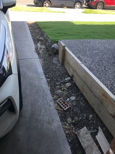

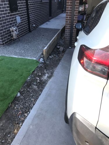

Hi there, need some suggestions on how to cover this patch. This is on the boundary between my neighbours and my Drive way. My house has fall and on down side.
some thing abit low on budget and can be done by myself

Hi @shary,
Given you are on the lower side you'd likely need to continue that timber division along with a timber plinth and stakes. Once the edging is in place, you'll able to level the ground on your side, lay down weedmatting and then pour pebbles or mulch over the area. Alternatively you could look at improving the soil with premium potting mix and putting a planting along the area.
