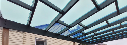

It meant I didn't need regular battens going across the rafters (and my noggins were aesthetic) . There is no regular corrugation, only at the 600mm mark to fit over the rafters. Is really easy to install. Provides excellent thermal protection from the sun (on a hot day, you can't stand barefoot on my deck, except where the light is passing through the roofing) and most importantly is crystal clear, so it looks like window glass and you can see the stars through it! I went for the "Bluish Breeze" version of this as it had really good heat shielding capability (45%) compared to the amount of light lost through the product (30%) vs the clear which only shields 13% and the grey which shields 56% but has an 80% light loss.

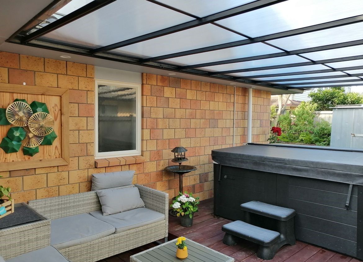

This was the result:
