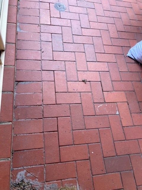

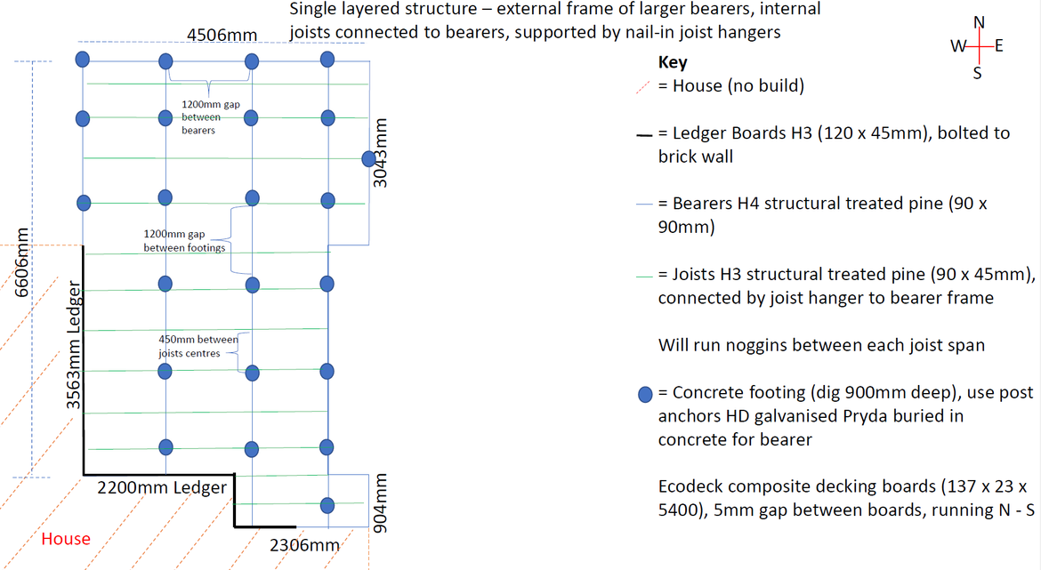

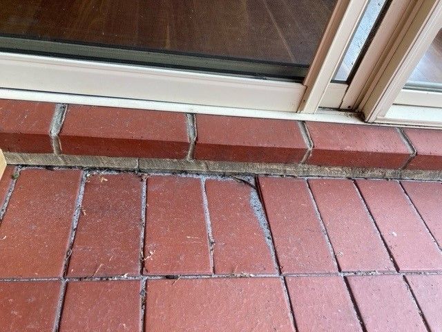

Hi All - having never attempted a deck build before I have decided to create a revamped entertaining space for our backyard which is difficult to access but lots of potential. I had a few questions on a low-level, single layered deck over existing brick pavers which transitions to over fake lawn (which will be removed). Currently, as shown in the picture, there is only an 80mm height from brick paver to sliding door height. If I remove the pavers I will have 130mm height to play with but could clear soil to create a minimum height if necessary. I have prepared the plan shown (apologies as it is my first effort) but in need of some advice, before I take a wrecking bar to the pavers (tight access space to backyard means everything by hand)!
1. Is it a viable option to connect bearers to these pavers directly with an 80mm height clearance to sliding door frame and then use post anchors in concrete over the lawn area which falls away towards a garden bed?
2. If not, and I remove the pavers - I have 130mm height to play with. I was planning to use 90 x 90mm H4 bearers to create a frame so that anchors to support the bearers can be buried in concrete. Joist hangers would then be used to connect 90 x 45mm H3 treated pine joists. This would only leave however about 17mm gap between concrete and anchored bearer for ventilation. Composite Ecodeck boards to be used are 23mm. Is this a sensible plan or is there a better alternative (such as strip-bearers laid directly on a gravel bed)?
3. For a low-level deck, is it ok to set a bearer directly into concrete using post anchors and not have them sitting on top of separate buried/anchored posts?
4. If the plan above is the right approach and I remove the pavers, then I have a fair task of digging about 22 post holes for the concrete to connect the bearer anchors to. I have assumed about 1200mm spacing between concrete footings with anchor. I cant find a span table to confirm this - is my approach correct?

With only 80mm worth of height you'd need to turn your joists on their side so they are only 45mm high. It's best not to do that, as there will be such minimal airflow within the deck that the early onset of decay is guaranteed. It would be best to remove the bricks to get that additional height.
With 130mm of height, you could compact the ground and use Builders Edge 35 - 60mm Smallfoot Pedestal Feet. These feet are adjustable, so they are perfect for levelling your deck. You'd have the feet set at 38mm, a 70 x 45mm joist and the 22mm decking. That gives you your 130mm height. You'll need to support the 70mm joists more often than the 90mm at around 800mm centres, but this method will save you from digging a bunch of holes. Unfortunately, I've just spent some time planning this out for you, and the cost of the feet could make this quite prohibitive. I've included the render in case it assists.
The method you've suggested would most likely work, but given the deck size, I'd first check with your local council to see whether you need to submit plans to them for approval. If so, you'd likely have to take your design to an engineer to have it approved.

It is possible to use angle brackets, however, I'm afraid drilling into your pavers may not be enough support and there is also the possibility of the pavers splitting in half. I know its extra work, but I suggest removing the pavers for a more secure deck framing.

It's good to hear that you've managed to create more space for your deck. A tricky question indeed between using the 90mm or the 70mm framing. If you use the 90mm timber, you'll be able to spread the distance between the pedestal footings to 1000mm. If my calculations are correct, it will conservatively save you 16 pieces of pedestal footing.
