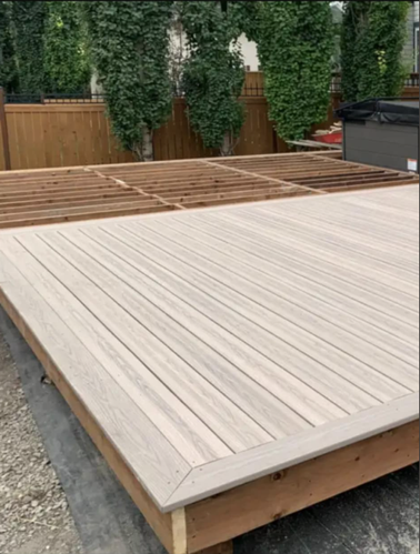

Now would anyone here have advice on how to do a picture frame style deck boards? I want to know if you start the border picture frame first or do you do that last and after you put all the main boards on ?
Picture frame deck like this picture:
Re: How to build a small deck for timber cubby house?
Hello @PatDIY_Dad
I suggest having a look at this discussion - Picture frame decking frame dimensions? by @Alan__. Mitchell gives a great explanation about picture framing.
